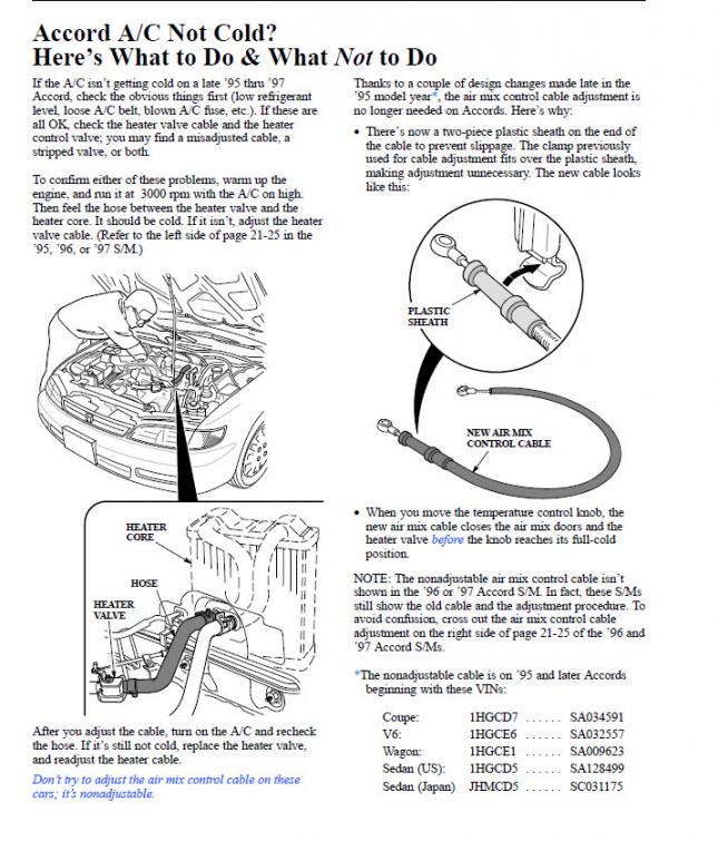

As suggested, a reading from both the high and low side is really needed.
Also, this gen does have a bit of an issue with the blend door and heater control valve cables getting out of adjustment - trust me I have a 95 and have to adjust mine fairly often. When this happens the blend door isn't closing off - not all of the "air" is flowing over the evap....and the heater control valve is not closing off allowing hot coolant into the heater core....so you are heating up the air at the same time you are trying to cool it.

The following attached pic. has info. which is in line with what poorman212 just said.
https://www.hondaaccordforum.com/for...c-not-cold-jpg
