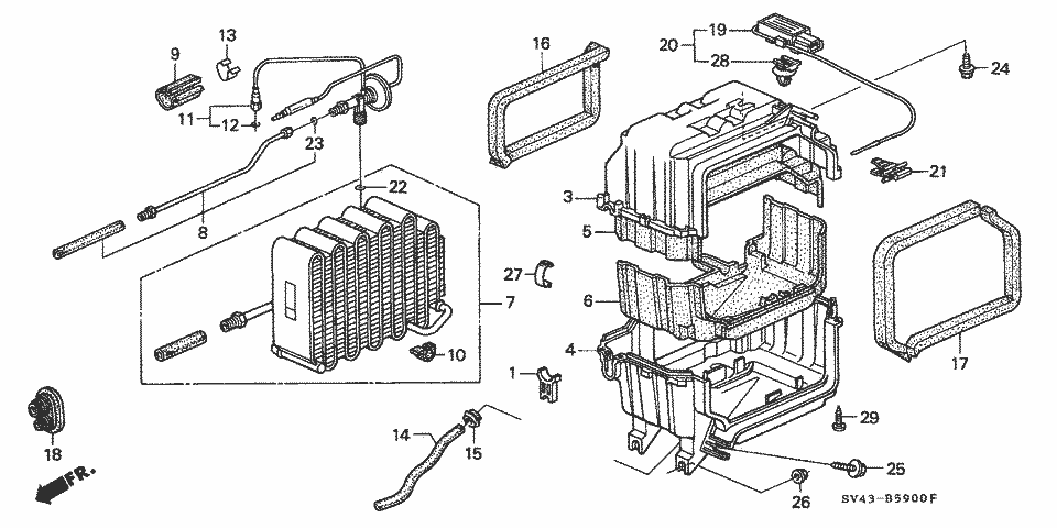

The entire round blower housing is over to the side of the AC core, on the far side of the picture. It connects at the #16 gasket.
The thermostat sensor #19 is on the opposite side (air outlet) of the evaporator, but you can look for the connection wires outside of the central "box" of the ventilation system.
