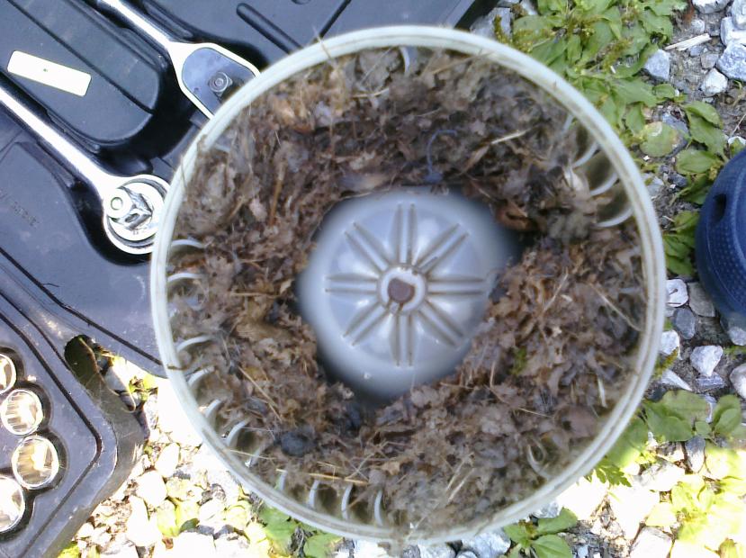

Well...hopefully this picture uploads. It appears someone was living in the blower fan. After I took it out, cleaned it up, and replaced the cabin filters.....everything appears to be fine. Just wonder where the guest went. Thank you for all the replies!!!! I really appreciate it!!!!
Nice garden you were growing in there...

definitely pac-rats ..

It could have been a hamster thinking he was in a hamster wheel.
