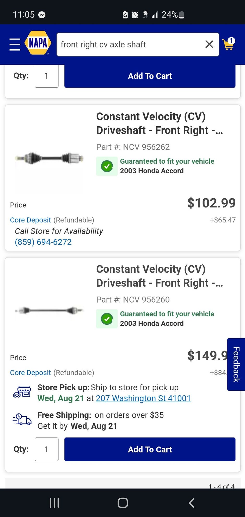

Most stores are showing this BIG FREAKIN LONG right hand CV Axle... its not right. Its supposed to be a little short thing at the end of the Intermediate shaft. Napa, i think it was showed 2 different right CV axles, one long one short both for a manual trans, both "guaranteed to fit" lololz.
Most stores online show up a whole cv/int "half shaft" in my google search that turns up to say Does Not Fit. Chase down the number, its for a hyundai....

The NAPA long CV joint is probably for an AT. The NAPA short and long CV joint are probably the intermediate and outer CV shafts respectively.
