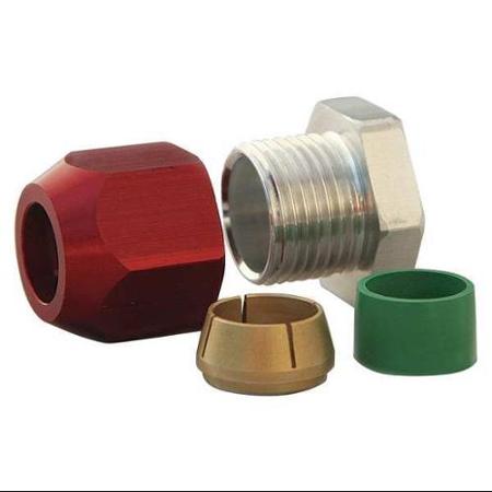

I have a 100 series land cruiser that has a leak in the ac lines to the 3rd row A/C. the leak is in a 6ft section of line that is a $120 part that is damn near impossible to replace. I don't even have the third row seats in it so I decided to cap them. I bought some caps from airsept I had read about, installed them, but can't get them to hold a seal. took them off and put them back on a few times and no luck. Is there an easier way to do this? With the weather heating up having AC is a must. Would it be possible to have someone crimp and weld the lines? Or is there another solution?

I rigged the cap on with some added epoxy last night and it seemed to hold under 20psi. Gonna check it today and see if the pressure has dropped but even then not sure how permanent this will be

Well after a few days the pressure remained the same with just the caps+epoxy so went and got it filled so hopefully it holds now. It was rough driving it around without AC in the meantime.
