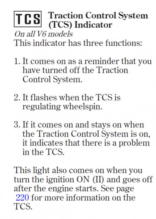

The other problem is that the TCS light always illuminates when the CEL does, no matter what. Has anyone else experienced this? I don't have to tell you guys that the TCS light being illuminated means that it's off. When I turn off the car and turn it back on, the TCS light goes away but the CEL remains. This also happens intermittently with the side airbag light.

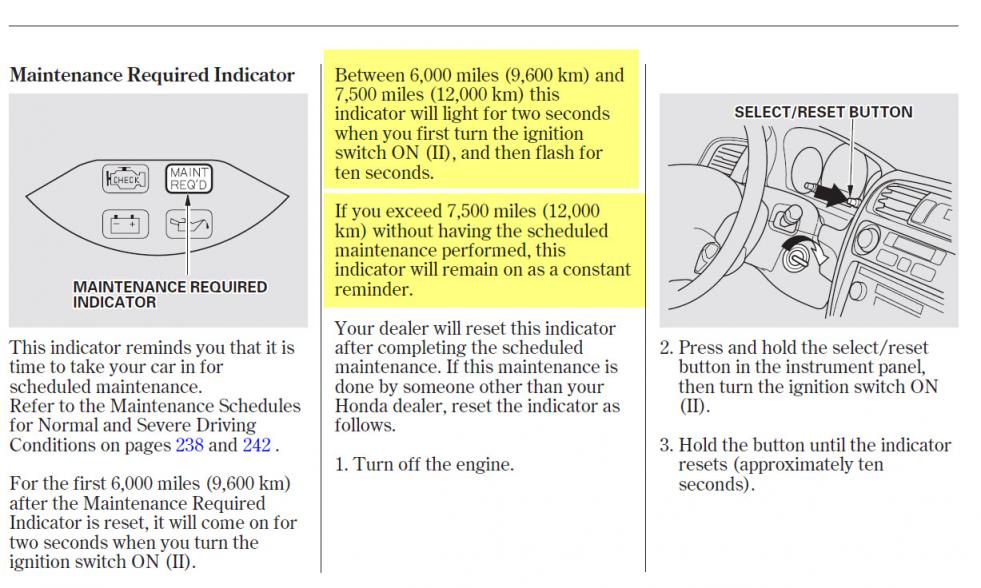

Lastly, is the maintenance req'd light set to illuminate at certain mileage intervals from the last oil change? I ask because I recently made the switch to high mileage synthetic (the CEL and such was happening before this change) and I know for a fact I can go at least 6k miles on synthetic before my next oil change. I imagine the light illuminates after around 3k miles from the last time it was reset, is this correct? I know I have barely driven over 3k from my last oil change, much less 7k.

  • TCS indicator light on can mean more than just the TCS off. It can also mean there is a problem with the TCS. (See attached pic.) Get the car scan for trouble codes when the CEL is on with the TCS. Gol to Autozone to get the code read for free.

  • The maintenance required indicator comes between 6,000 - 7,500 miles for ten seconds, after 7,500 miles it stays on if not reset. (See attached pic.)
Attached Thumbnails CEL and TCS in tandem, EGR ports-tcs-indicator.jpg   CEL and TCS in tandem, EGR ports-maintenance-required-indicator.jpg
