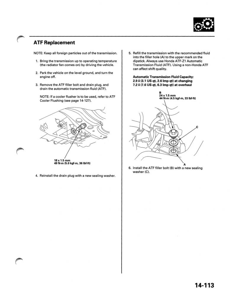

On mine, I just drain and replace about 2.5 quarts with Z-1 (now DW-1?), no need to jack up the car.

I was kinda right, kinda wrong. Heres the page in the FSM for the V6 6th gens. And I would not recommend anything but Honda/Acura transmission fluid. Its worth paying a little more for your car in that department, considering how expensive transmission jobs are.
