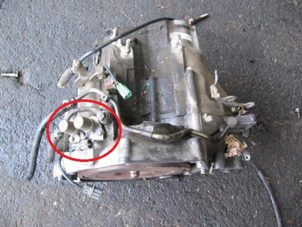

Just looked at the shop manual in more detail, you got a code 1.
You can test the resistance between the lockup solenoid valve connector to ground. The electrical connector has two pins, because there are two solenoids in there. Each pin to ground should 14-16 ohms. If one is way out of spec, then you should replace. The lockup solenoid valve is on top of the transmission.
Red circle on attached pic shows the location of the solenoid.
Attached Thumbnails Classic Accord trans problem D4 light please help ASAP-.jpg

Yup its the solenoid. I'm gonna replace them this weekend. Just curious what would've happened if I would've driven the car as is with the faulty solenoid? I knew someone who owned a cadillac with a the same problem but the solenoids on the cadillacs are internal inside the transmission and his car drove fine.
