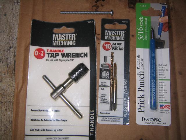

Okay I got what I need except for the slide hammer. A punch ("***** punch", although instructions said "center punch", I guess it's the same thing and will work to make a center indentation for my drill bit), the #25 drill bit, the 10-24 tap (and a tap handle), and the 10 x 24 x 3 inch screw.
TexasHonda you mention using J&B epoxy to plug any holes I might drill through the plugs. First of all, should I try to avoid drilling all the way through the plugs? Wouldn't it be easier to just drill all the way through the plugs and that way maybe the screw gets threaded more securely. Also, I have some JB Weld, is that the same as this J&B epoxy you mention, or should work just as well if not? Thanks
