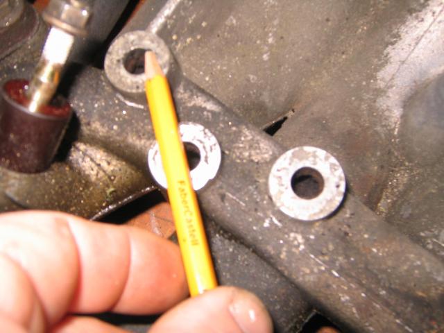

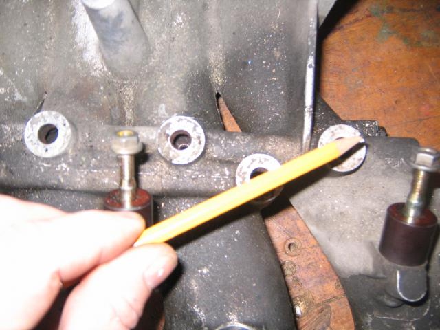

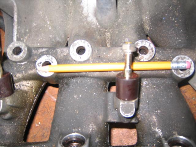

Okay I'm unclear on which directions, between which port holes are the "crossover" passages I'm trying to fish a wire through anyway. Any of these directions?
Attached Thumbnails clean egr ports 92 accord-img_2310_zps42c49c9b.jpg   clean egr ports 92 accord-img_2309_zps1b4d5143.jpg   clean egr ports 92 accord-img_2308_zps4defeed7.jpg   clean egr ports 92 accord-img_2307_zps1249c974.jpg
Old Jul 6, 2013 | 03:18 PM
  #30
Posts: 7,101
Here is a better copy of the Honda TSB, so you can see the cleaning directions better.
Honda TSB 98-074
