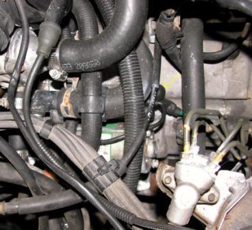

Coming off the Pos side of the battery the cable "splits" into two. One will go to the under hood relay box. The other goes to the starter. If you remove the air intake "tube" that goes from the pass fender to the air cleaner you can have a better view. The attached is from the 88 LXi Auto. You'll see a bit of "green" center/left-that is the starter. I tried to draw a yellow line to where the pos cable connects to the starter...
EDIT: Still suggest having the batter tested. Do you have a volt meter?
