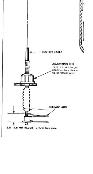

Anyway-OP, there is an adjustment that can be done on the clutch cable. I want to ask a few things first. When it was driving, "about where" was the clutch engagement...way high or way low...low being close to the floorboard?
Check/change the fluid in the trans as soon as you can.....10w-40 engine oil will be fine for this.
For the adjustment....and I hate to post this as my opinion is if everything is working properly you NEVER need to do this except when the clutch it replaced on these.
You will need to "pull" up on the cable gently to turn the "****"....there should be a rubber "gasket" with a "nipple"....this "nipple" kind of locks the **** from turning when at rest....that is why you pull up so the **** does not break the nipple off.
Attached Thumbnails Clutch or tranny problem - 1989 Accord-3rd-gen-clutch-adjust.jpg

I adjusted the clutch there is play on it now it feels good but would go in gear any other suggestions? The fluid level is good I will replace it tomorrow if it will make a difference. Thank you in advance
