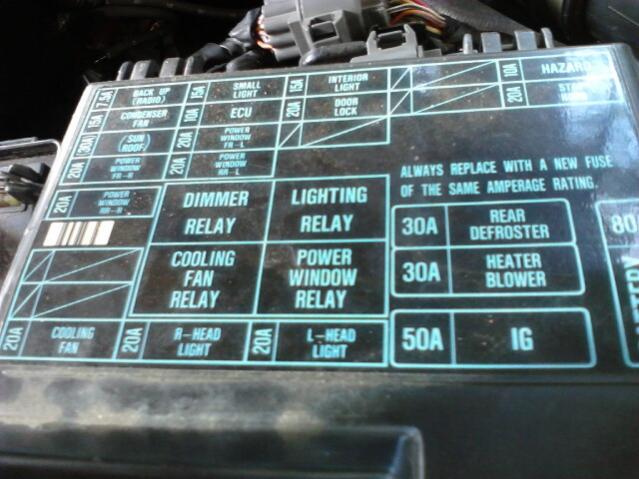

I don't know the numbering system for these but the fuses are all correct according to the diagram(I checked both boxes, I know these often do more than simply the one thing they indicate) and the only one blown recently was the 7.5 for the radio (probably has some thing to do with my dad putting in a new stereo for me). I went ahead and tried a brand new relay and it didn't help. The condenser fan has two plug ins, I can only see one on the radiator fan, down left battery side. is this the only one?
I don't currently have access to a volt meter, but I will see if I can rent or buy one from the machine shop if you could just tell me what I should be checking with it. Thanks.

I need to understand what is currently going on.
1. Which relay did you change?
2. If you jump fan Switch A with the ignition on, which fans currently run?
3. You can pick an inexpensive multimeter from Harbor Freight for $5.99. Sometimes it is free with any purchase. if you have a coupon.
We would be testing for power/voltage on the fan circuit power wires and for continuity on the ground wires.
Initially, I was trying to guide you through some tests without the need for testing equipment.

Old Sep 22, 2014 | 07:24 PM
  #20
The driver's side is consider the left side and passenger the right side.
From this image, which fan is not working? I just want to confirm.
