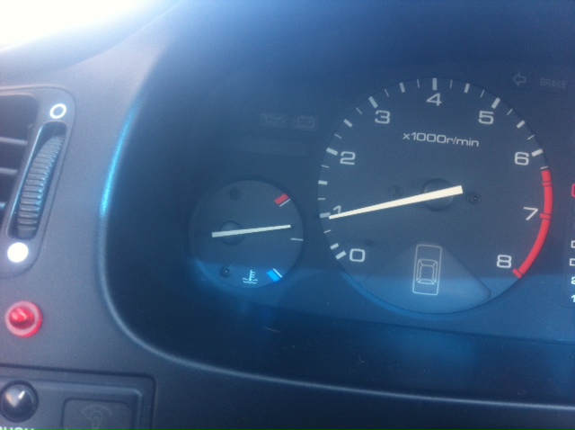

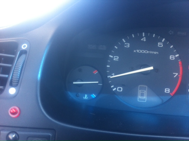

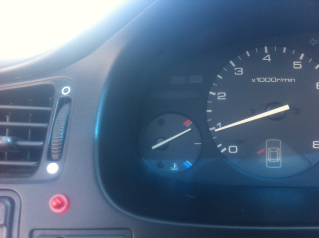

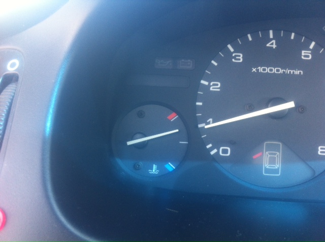

Here I am, back to square one:
Replaced the Radiator cap, seems like overflowing of the tank issue has been resolved.
But car still seems to overheat, have a look on the attached pictures.
I face this over heating issue only in stop and go traffic, at a stop or when I put the car in 'park' after a 1 hour drive.
Only thing left is, Thermostat, since I have replaced A/B switch, radiator, hoses.
Also, if I touch the upper/lower radiator hoses, they are HOT, like hell
Are all pointers towards the Thermostat or something else?

Car definitely overheats, as posted in my previous pictures, where you can clearly see gauge rising and going towards the 'Red' mark
