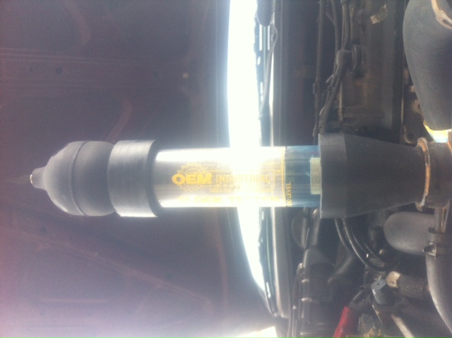

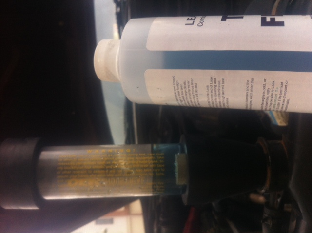

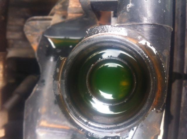

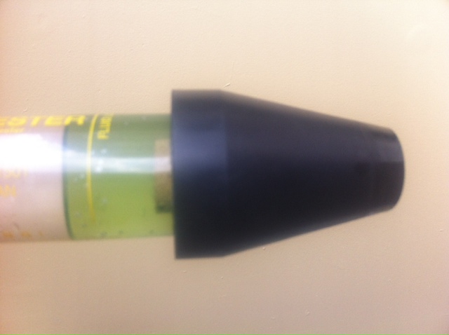

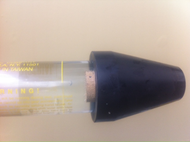

I did the combustion leak test today with the 'Blue Liquid'. That's how I did the test:
1- Started the car from Cold start.
2- Sucked some coolant with Turkey baster, maybe '3-4' times.
3- Placed the tester in the radiator while the car was idling in park.
4- Pumped the 'ball' thing maybe 10-12 times, liquid did not change the color.
5- Discarded the old 'Blue Liquid' filled it back and then fired the car again, pumped the 'Ball' maybe 5-6 times, then reved the engine and still the coolant color was blue, but after few min it started to suck the 'Green' coolant and color did not change to 'Yellow'.
6- I tested to make sure if the tester can suck liquid inside by using water and indeed it was able to suck inside.
7- I am using Green 50/50 in the radiator.
See the attached pictures.
Does anyone of you still think it's a HG issue? Did I do the test right? Am I still missing anything?
Thanks again for the help.

Here is a video on how to do this test.

Got an IFR temp reader? I'd want to see what it says the temp of the cyl head is.
Could be a sticking stat or a bad temp sender?
Just me but I like using the block check test fluid to find bad HG. It tests for exhaust gases in the coolant. The kit is ~$25 and the fluid is ~$7, some have said autozone rents the kit so you only need to buy the fluid.
not to be rude but do you know what the head temperature parameters are for a healthy engine using IFR?

I am also trying to be cheap, and planning to fix it by myself.
Ordered an OEM Honda t-stat yesterday, going to install and post back the results.
As block tester showed no hydrocarbons in the cooling system.
If t-stat didn't resolve the issue going to do a leak down test.
