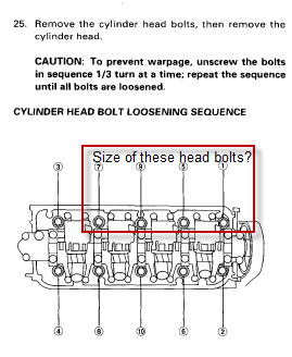

1-How should I pull the head-bolts off? They seem to be a PITA, I tried using impact didn't work, breaker bar--no luck. Then finally used a big cheater pipe and was able to break the lower bolts while upper ones, still they don't budge, Any special trick for it and are they the same size as lower ones(14)?

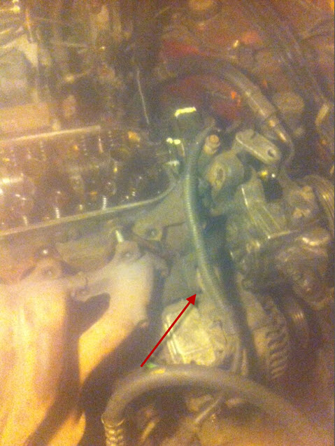

2-Do I have to remove the Alternator and engine mounts to remove the Head?

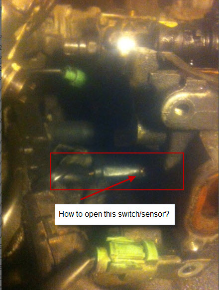

3-What's the name of the sensor/switch and how will it come out on the left side of block and back side of upper radiator hose entrance?

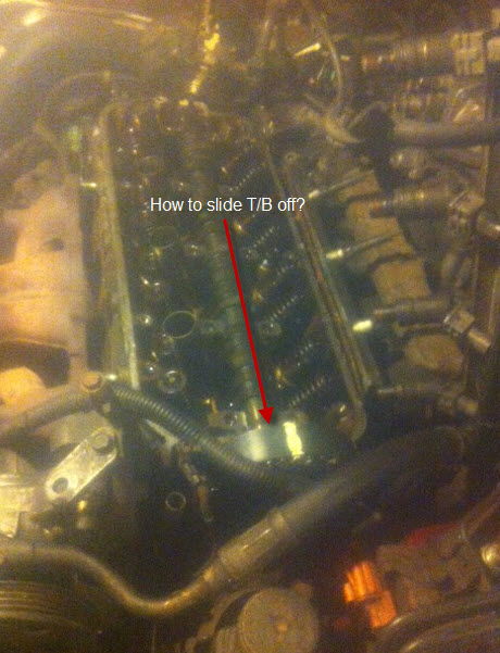

4-How will I be able to slide/remove the Timing belt off of camshaft?

Tilt the end of the camshaft (opposite the gear) up. The timing belt will slip off.

Thanks again for helping out a noob, really appreciate it.
Yes, I just looked again and now understand what you are saying, belt can be removed by sliding, but while installing would it be hard to put the belt back on since I will not be touching belt tensioner?

Reverse the process when putting the cam back in: tilt the back of the cam up, put the belt on, and tilt the cam back down.
I'm surprised that you're having problems with head bolts. They should only be tightened to ~72 ft/lbs, so getting them loose should be pretty easy. You're using a six point, 1/2 inch drive socket?
The FSM says to loosen them 1/3 turn at a time in a certain sequence to keep from warping the head.

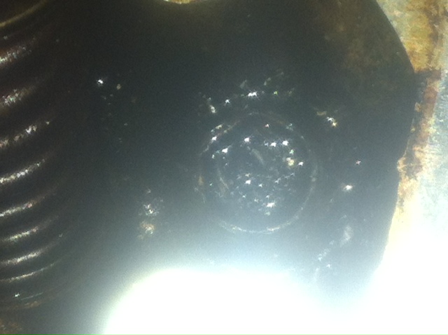

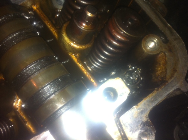

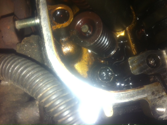

I am able to crack 8/10, while '2' are still stuck and proving to be a PITA for me :thud:
Please have a look on the attached pictures both are from the right side of the head(Upper and lower):cry:
Please advise, how should I crack them?

Any cheap recommendation to get just '4' cylinder headbolts?
