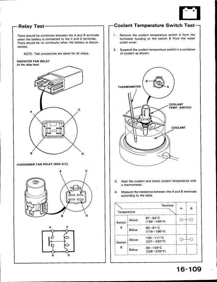

I have a feeling youre right and the fan timer unit is bad which is why the fans are doing the wrong thing when theyre jumped. It seems like the creative wiring doesnt extend into the harnesses or anything just like they tried resplicing things to see if they could make it work. Anyways I found this in a manual to test the coolant temp sensor # 14 and 15 on the diagram. Its testing for resistance. It says to measure resistance between the two terminals and compare it to the chart however I dont see any resistance numbers on the chart or anything unless those barbells mean something and I dont understand what its saying??? Also the next page in the manual is off to another topic So it says to measure resistance but doesnt tell you what it should be, Only thing I can think of is that barbell means 0 resistance at that temp??

That wording is really misleading...
Those aren't sensors with variable resistance. They're switches. You don't measure resistance - just measure continuity.
Most multi-meters have a continuity setting where it BEEPS when there is continuity. Otherwise, use the RESISTANCE setting. Open circuit (below the switch temperature) it's like the leads NOT touching. Continuity (above the switch temperature) reads about the same as when you touch the leads together.
