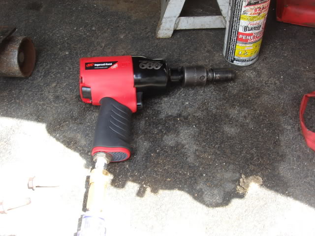

Hmmm .... I prefer the Ingersol Rand 600 ft.lb. double hammer method

It took 5 seconds with the can and gun that are in this pic.
