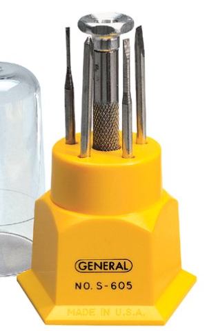

To unstick the key from the keyway, I'd try wedging a (for lack of a better term) "watch-maker's" screwdriver between the key and keyway, right at the front of the crank, at the bottom of the "U" channel, where the bottom of the key meets the bottom of the slot in the crank. (A large, very-fine-point steel sewing needle may do the job, too, but I'd try that small screwdriver first.)

It has to be a very small, thin screwdriver like the ones in the "jeweler's" set below:

Thank you thank you one and all. Tony you were right. I got a small jewelers screwdriver and tapped lightly with a hammer under the key. It took a few goes of driving the screw driver under the key taking it out until it finally broke loose enough to pull out. SO THANK YOU. And thanks to ericthecarguy.com for a great video which is how I was able to do this in the first place.
