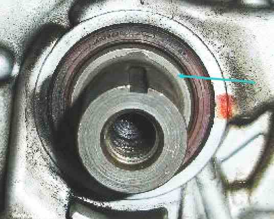

The question thatI wantansweredis: why did the new pulley fail?
Here's a closeup of the crank and seal:
The blue arrow points to what I believe is a "shoulder" on the cranknear the crank seal. Like a stack ofpancakes, the timing belt gear pulley (closest to the engine), balancer belt gear pulley, and, finally, the crank pulley "stack up" a little bit "thicker" than the distance from that shoulder to the very end of the crank shaft. That nice looselittle crank pulley bolt keeps the "stack" tight against that shoulder, WITHOUT either bottoming out in the threaded hole, or touching the flat end of the crank. I might be wrong on that last part,but I'm sure someone will correct me if I am.
Come to think of it, the next time you get that crank pulleybolt out of there, without removing the pulley from the crank, take a look and make sure that when you push the pulley all the way onto the crank, the flat surface of the end of the crank still sits slightly inside (beneath)the outer flat surface around the hole of the pulley (the part of the pulleythe bolt tightens up against). If it doesn't, that's not good.
That leads me to another question - is the crankpulley bolt the OEMHonda original? It should look identical to mine. If it isn't OEM, replace it immediately.
If the crank itself is moving back and forth within the block, that's not good. I'm not familiar enough with the bearings of the crank in this engine, but on V8s I believe there is a thrust washer or bearing that prevents longitudinal travelof the crank. You can verify whether the crank is moving in and out during operation by installing a temporary makeshift "gauge" of some sort that is firmlyattached to the chasis andpokes out to very close to the pulley. That can serve as a reference for you todetermine if the pulley is indeed moving in and out as the engine runs.
Thelower cover plays no part in keeping anything anwhere. It's sole function is to keep the elements away from those delicate innards. Which reminds me, if your lower cover is not protecting everything under it from the weather, relace it with a used or new one. I hate to think what water and sand are doing to those tensioners.
As far as I know, it is impossible to remove the lower cover without going through that long procedure.As you said previously, maybe this is why the lower cover was damaged by a previous owner- to somehow get the cover off andavoid all of that hassle.
I have an attached garage with a nice concrete floor, but that was not always the case, so I can appreciate exactly where you're coming from and how that limits doing maintenance. It sucks. Combine that withunbearablyhot weather and it's the perfect recipe for a nasty, unenjoyable job.
I only used two jack stands under the front of the car. It isn't necessary to keep the car level when slightlylowering the engine with a jack.

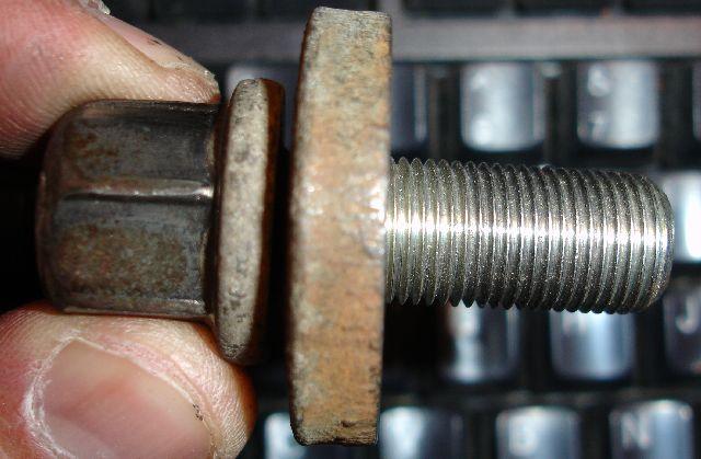

I just thought of something.
Because you mentioned that both the old and newpulleys "chatter",
you should definitely verify prontothat the flat end of the crank sits inside the surface of the crank pulley that the bolt tightens against.
Because it was loosened quite recently,it is almost certainthat the crank pulleybolt willbreak freeeasily now (famous last words), so checkingthis should be relatively easy. I also think you can do it without removing, or even loosening,either of thetwoexternal belts, although it would be better to at least loosen them so that the pulley can be easily pushed as far toward the engine as it can be.The only problem you might have is getting a decent view of the end of the crank after you remove the bolt. Maybe you can see well enough if you look through that star-shaped access hole in the splash guard inside the wheel well (with the driver's side front wheel either removed or turned all the way left).
I reiterate this point for two reasons:
1. If the end of the crank pokes out slightly from the crank pulley, that means that the bolt will tighten against the flat surfaceof the end of the crank, rather than against the pulley. In that case,all three pulleys on the shaft will "float". They will slide on the crank shaftin and out between the shoulder of the crankand the bottom flat surfaceof the headof the crank pulley bolt. That movement may not be much, but it might affect the longevity of all components under the covers - particularly the belts and tensioners, I would think. This sliding movementmight also causethe chattering sound.
2. You say the lower timing cover has been repaired with bondo. How, or why, was that cover damaged? Was it damaged on purposein order to remove it without removing the upper cover? If so, why? I can't help but think that maybe one of the two pulleys underneath were replaced for some strangereason.
While you've got the bolt out, you can also verify that it looks identical to this one:
As you can see, there's a large, thick washer under the head of the bolt. The washer can rotate quite easily, but, as far as I could tell, it could not be removed from the bolt. It seems to me that the bolt must have been threaded after the washer was installed onto the bolt.I might be wrong on that last part, though.
Good luck.
