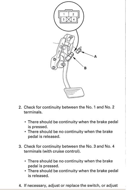

Old Jan 26, 2013 | 08:09 AM
It can "look" closed but testing the pins on the switch would be the best.
Attached Thumbnails Cruise control intermittant 2003 4cyl-7th-gen-brake-switch-test.jpg

Just an update on cruise control. I've noticed that if I try to put cruise on and it does not work, I just put my foot under the brake pedal and pull up just a bit it and then hit the cruise button it works every time.
Old Feb 23, 2013 | 11:43 AM
Dr. Drivability's Avatar
Joined: Aug 2011
Posts: 1,149
time to adjust or replace the stop lamp switch.
Old Feb 23, 2013 | 11:51 AM
Brake light switch is either out of adjustment or sticking. You can loosen the lock nut and give it a 1/2 turn (or so) in towards the pedal and then tighten the lock nut.
Think of the brake switch as having three positions.
Brake lights on - brake lights off - cruise circuit closed
The fact that you can "lift up" on the brake pedal and then the cruise works tells me that something is not allowing the brake switch go from "brake lights off" to "cruise circuit closed".
