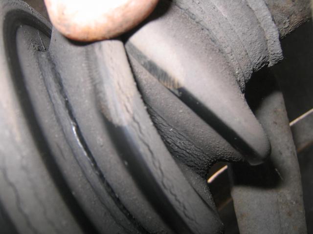

On inspecting the condition of the CV joint boots on the right side (92 Accord DX), I see the rubber has some cracking but it's not all the way through (yet) anywhere. The left side half shaft was changed out about a year ago so boots are still fine on that side. So I was wondering about the idea of changing just the boots on the right side, before they crack all the way through and the grease inside gets contaminated. Some say just replace the whole half shaft but I wonder why do that (spend that much more for a new halfshaft) if it's just the boots that needs changing at this point. Any comments appreciated.

Is that cracking through the caked-on dirt? Or cracking partway through the rubber? If the rubber is cracking, I'd get those replaced before they split open. Kinda unpredictable how long they will last.
I've done boot replacements on several of my cars with good results. That's along with cleaning & re-packing the CV joints.
But for Hondas in particular, it seems that replacement axles are much cheaper than those for VW or Saab, so replacing the axle is a real popular way to deal with it.

Is that cracking through the caked-on dirt? Or cracking partway through the rubber? If the rubber is cracking, I'd get those replaced before they split open. Kinda unpredictable how long they will last. I've done boot replacements on several of my cars with good results. That's along with cleaning & re-packing the CV joints. But for Hondas in particular, it seems that replacement axles are much cheaper than those for VW or Saab, so replacing the axle is a real popular way to deal with it.
That's cracking partway through the rubber, not just through cake-on dirt. Yes, that's what I was considering, going ahead and replace them (or the entire halfshaft assembly I suppose) before they split open (don't particularly want/like the grease slung out along the underside of the car when that happens, for one thing). I checked prices for a replacement Cardone axle assembly for the vehicle and it'd be 45 bucks which isn't too bad, although my location (in SE Alaska) shipping is another 30 bucks.

I definitely understand that line of reasoning, but we know it won't be long before the cracking rubber splits open, and the grease inside probably gets slung out all over the underside of the vehicle. I was thinking along the lines of preventative maintenance, just fix it now if I can instead of waiting until it gets worse and more than likely I end up having to deal with at a less convenient time. I could wait I suppose, until it splits open, and the joint starts "clicking". Not sure how well I'm going to be able to hear this clicking when/if it happens anyway, nor if I want to be having to listen for it.

Pick up a new/reman shaft from the local parts store - I know there is one not too far from you......and call it a day.
You could just keep going until it totally goes but if your luck is like mine - that would happen in the dead of winter and your winters are something else.

If you have the skills to do just the boot than that is all you need but if you don't get the whole shaft. If you buy OEM Honda boots and use the correct tools to install the clamps than than the joints should last a long time. If there is water in the joints than you will have to examine the CV joint for damage before going the boot only route.
