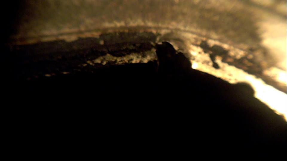

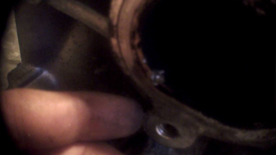

Hey all. I have a F22a engine from a Honda accord that needs a new head gasket.
I decided to get the F22B Dohc cylinder head and change my sohc to a dohc with one fowl swoop.
However, during the shipment of this said dohc cylinder head, damage occurred.
I have pics. The worst damage is circled where the combustion chamber is. There is a rather deep gouge and
I am concerned that this will be a problem even after I have the head milled down.
See pics. The first one is a regular pic, the 2nd is in macro which means is super zoomed in.
I though of JB weld but then heard that won't work, then I thought of welding but that would cost too much cause you have to be really skilled to weld on a head surface. I just don't know what to do. I'm hoping that perhaps this won't be a problem since its not a huge chunk that is missing, just a quite small piece. But its where the pressure in the combustion chamber is, that is why its such a concern. Perhaps it will blow out a head gasket.
Please let me know what you guys think, is it okay to use this or not? What should I do if its not okay?

find someone or shop who can TIG weld. Weld it up and have it resurfaced you should be fine

I would guess that the chunk missing from between the cylinders will cause you problems.
The only way to fix this is to see if a machine shop would be able to fix it. I highly doubt it they can fix it, but it is worth a shot.
I thought the head gasket for the F22A engine doesn't matche the head from the F22 DOHC. See how your new head gasket lines up to the DOHC cylinder head.
Plus the timing belt would need to be different to accommodate both cam sprockets.
I would stick with repairing the cylinder head you have (or a rebuilt one). See if you can return the damaged one you received.

the f22b head will be a direct swap as the f22b is the same as all the rest off the f22a/b blocks.
Timing belt is a must but I'm 99% sure the headgasket is the same. That really isn't all that bad of damage if you can find a TIG welder to simply weld over the spots and have them smoothed out.

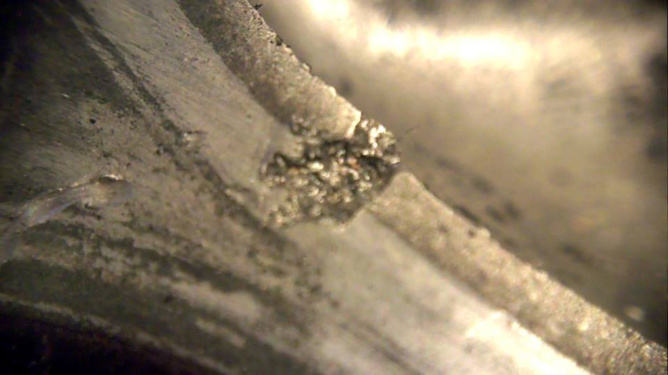

Another thing, should I weld this exhaust port as well it got gouged as well. I think it would be a good idea to weld this as well, don't you thing?
Macro'd:
What do you think is a reasonable price for all that, I don't wanna spent more than 50 or 60. I can burr it out I have a carbide burr. All I need done is the weld... But thanks a bunch I was getting concerned this wouldn't work out. Payed 190 for the head and manifold, 90 for shipping and 100 for the rest. It came with the intake manifold, injectors and the idle air control valve. Those are all on eBay right now. I got OBD II injectors with the green tips and plug type clips, they fit in the 97-2001 Prelude, and the intake manifold has 1 bid already.

ehh the exhaust side really isn't gonna matter. I would just take a dremel and smooth it down but from your pics it doesn't really look like it's gonna hurt anything. As for the welding me personally as a welder I would charge roughly $40-ish as TIG welding is a PAIN aluminum is such a soft metal and you have to be very carful when welding on it. A shop will prob charge you half hr to a full hr in labor so it really depends on the shop. I would find someone who dose work on the side first before going to a shop.
You can also look over at cb7tuner.com for the head swap and they can tell you 100% what all you need for the swap. Good luck to ya!
