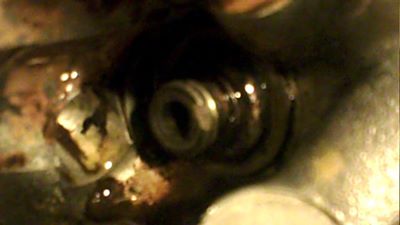

OKay thanks guys for the heads up. I got updates. Just got done removing the valves and the stem seals. I used a pry bar which went very smoothly for the last dozen of them, till I used a little too much force and heard a small *snap* noise.
This snap sound was a small part of the upper portion of the valve seat breaking. You can see the pic here:
Will this be a problem? In my opinion I don't think it will be a problem because there are two notches on the valve seat that hold on the seal, I only broke off the top one and in a small place... Just let me know so I can get some affirmation, that would be much appreciated.

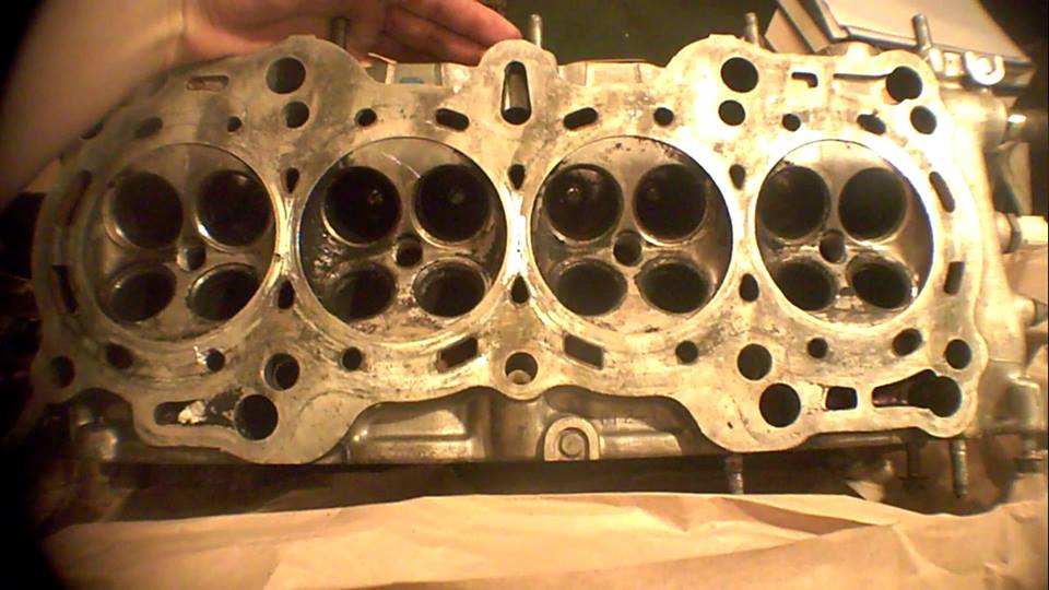

And here's what the head looks like without the valves. Needs some serious cleaning on the intake side,
Attached Thumbnails Cylinder head damage-1468713_609837519074962_502660119_n.jpg   Cylinder head damage-644507_609837542408293_2131956188_n.jpg

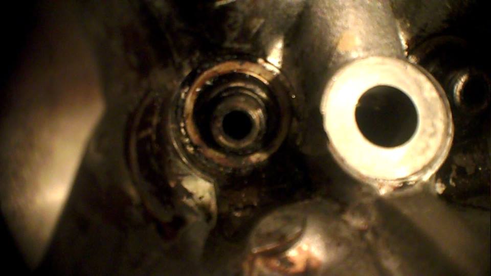

Here's a better pic of the chippage,
I think just some JB weld would fit that up fine, no big deal. I don't want to do extensive work on this head and remove the guides, that's just too much money. It is a JDM head and a rarity, so I'm excited to get this swap done right. Let me know what you'all think.

Just me but JB Weld on that is a bad idea.
Doesn't look like it got to the guide side.......so I'd have new seal installed and see what you have from there.
Okay thanks for the reply. I will try that and then have the gashes welded up.
