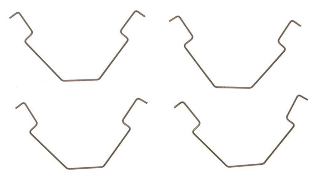

Anyone use these? I was thinking about using them, I need to install rear pads soon.
"Disc Brake Pad Drag Reduction Clips"
I have similar spring clips on the hydraulic disc brakes on my Mountain Bike. The clips push the pad off the rotor, when your foot is off the pedal.

I haven't. Let us know how they work out.
My suspicion (and it's only a suspicion) is that IF they push the brake pads too far out, you won't have any brakes unless you pump the pedal.

I'm trying to figure out what good they'll do; automobile disc brakes are not the same as bicycle brakes in that they don't need such springs to force the pads to disengage. Think about it this way, if the brake pads on your car were constantly dragging, said pads would wear out very quickly, your rotors would overheat, and your brakes would fade away to nothing when used in even the most mild of driving conditions.

Honda has used them in limited situations. For example, for the 8th generation Accords, when there were complaints of the original rear disc brakes pads wearing fast, they revised the brake pad material and included one spring for each side (2 total in the set) to insert into the lower part of the pads. (The original pads set didn't come with the springs.) -- Currently, the revised (again) rear brake pads for the 8th generation Accords did away with the spring, as Honda may have realized their revised brake pads and switching the caliper slide pins were adequate.
The original OEM front disc pads for the 8th generation Accords also didn't have them, revised front pads sets included two springs for each side (4 total). Generally, most 8th gen. Accords didn't have pad wear or noise issues. -- Go figure?

On my Saabs, there's an anti-rattle spring of a different design than Hondas. It IS possible to install it backwards, then it acts just like that spring. It pushes the pads away from the rotors. When you install it backwards, your brake pedal goes right to the floor & you have to pump the pedal to get the pads back into contact with the rotor. Scary thing... so I hope that someone isn't actually marketing something that does that.

The picture in the original post are parts from Raybestos.

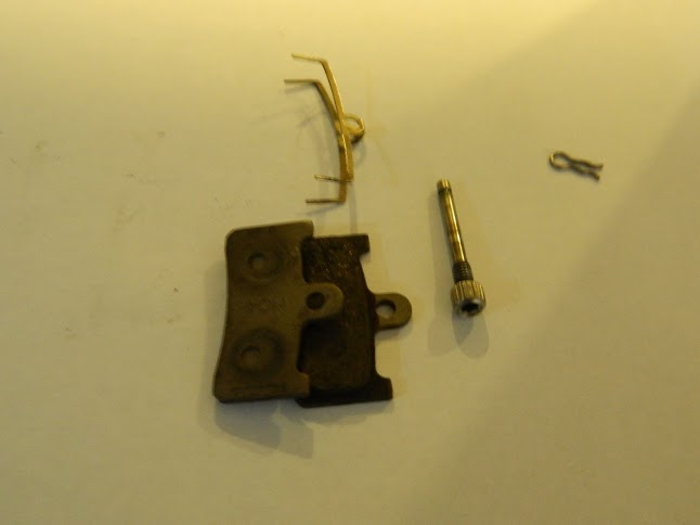

The bicycle brakes I am referring to are not what you describe. They are miniature 4 piston.
drag reduction spring and pads.
My rear brakes seem to need pads every 15-20k miles. Maybe it is because the fronts don't do their job as well as they should, I'm using Wagner TQ pads and Centric premium rotors.
I am not going to replace the rotors and pads until next month, I will update then.

I'm a road-bike guy, so the comment about cables... Still, the adjustment on bicycle disk brakes is more accessible, and they shouldn't wear as fast (speed & mass = far less energy to dissipate).
Does the master cylinder on the bike have a vent that opens to the reservoir when you release the brakes? On a car, that vent provides the auto-adjustment that you need as the pads wear down. But that vent would also allow the springs to COMPLETELY retract the pistons and then your pedal would go to the floor on the first pump.
I'm not sure but suspect that vent (and how the auto-adjustment is done) is the big difference between bike & car.
Still, try those springs & see how they work. Just check them out in the driveway & close to home to make sure they work OK.
