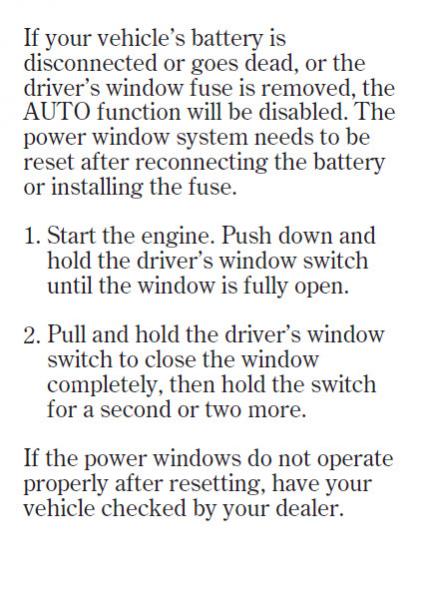

This is a shorter reset procedure to enable the auto function for the power windows from the owner's manual. (See attached pic.)
The rear power window problem may or may not be related it.

Old Jan 13, 2013 | 11:30 AM
I like that one much better than the service manual
Old Jan 13, 2013 | 11:32 AM
Posts: 7,101
Hi friend. Me too.
