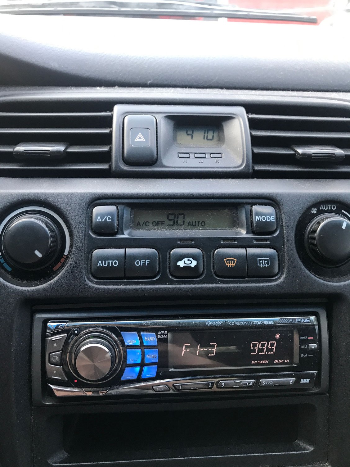

Hello everyone! First time poster looking for your help
First off is lucky enough to have a 99 Honda Accord EX v6 with 220k on her
- I have the automatic climate control feature. A couple weeks ago if it was set to 90 degrees I would have heat. If I dropped it below 90 I would lose heat.
- Now I have absolutely no heat.
- I have two hot hoses into the heater core but does not seem to be moving by the cable. I took the cable off and physically opened it myself and still no heat.
- no over heating or under heating for normal operational temp.
- vents seem to change when selecting. They might get stuck here and there.
Thanks for any help.

Suggest checking for DTC's. See attached procedure.
A frequent cause of no heat or no cooling is a failed air mix motor. Check whether air mix door is moving when temp control is changed from max temp to min temp.
i have the automatic climate control
Old Feb 20, 2018 | 03:38 PM
Wmertz63's Avatar
Joined: Feb 2018
Posts: 10
I have the automatic climate control. Control panel does not look like that.. tried playing around with it and got nothing

Ok - Ran the test and got D,KL
D - short in the outside air temp sensor circuit
L - an open or short in the mode control motor corcuit
K - A problem in the air mix control linkage, door or motor
going to google now. Any of these in common?
