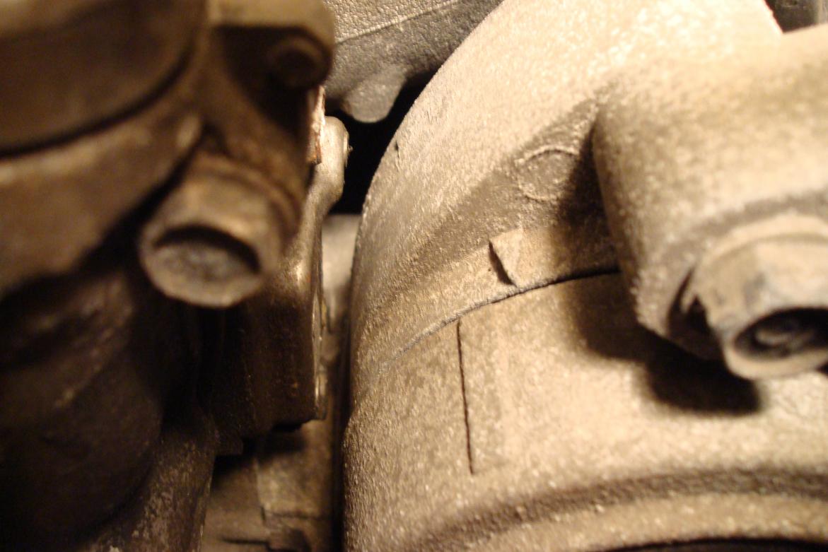

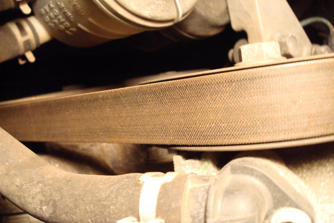

Looks like I am out of the range on the auto belt tension (see pic). Does the belt need changing (see pic)? It's a 2003 Accord 4 cyl with 212K miles. Thanks

The visual condition of the belt looks OK, but the tensioner position says the belt has stretched beyond spec. I'd replace it - at 212k miles, I think you got your money's worth out of that belt.
ps... Take a real good look at the tensioner pulley bearing, and any other stuff up there.

Also look at the underside of that belt to see if it has cracks across it..if so , it's past due..

Quote: The visual condition of the belt looks OK, but the tensioner position says the belt has stretched beyond spec. I'd replace it - at 212k miles, I think you got your money's worth out of that belt.
Just got quotes back from two Honda dealers. It's going to be $125 for part, labor and tax. Looks like I got my moneys worth!! Thanks.
