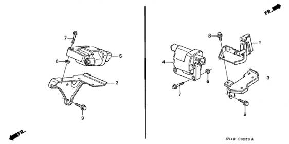

Your issue may actually turn out to be something different, it may be due to a bad ignition coil (Part # 5 in diagram). A bad ignition coil may cause these trouble codes and what you're experiencing.

We tested the coil and it tested good, we replaced the crank position sensor and it is still throwing the code. We have replaced the ignitor in the distributor, and the ecm. Does anyone have anymore suggestions we are at a stand still. There are no broken wires. The car sputtered out at 3500 tons and throws the code immediately. Thanks for any suggestions.
