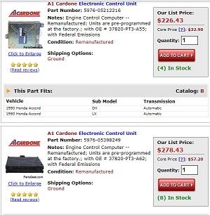

I have a 1993 10th Anniversary edition Honda Accord. About a week and a half ago my street flooded overnight and water got into the car. The area where the TCU and ECU are located under the passenger side carpet got partially submerged. After letting everything dry out for a week and a half the car starts and runs fine at idle. When driving it runs and shift great until it gets to 3200 rpms. Then it just stays and 3200 rpms and will not go above. When in park and running if you press the accelerator it will climb to 3200 rpms just fine but then acts like its hitting a rev limiter at 3200 rpms. I have two questions. 1. has anyone seen this symptom caused by a bad tcu or ecu? 2. When looking at replacement TCU and ECU they are listed for all other models of 1993 Accords but nothing specific to the 10th-anniversary edition. Anyone know which model of Accord ECU/TCU is compatible with the 10th Anniversary Edition?

It does have the same engine and transmission but it was confusing because the part number for the replacement ECU was different on two of the same year models that had the same engine and transmission

This should be the ECU model you need:
37820-PT6-A52
The model you have already should be:
37820-PT6-A52/3 or
37820-PT6-L52
