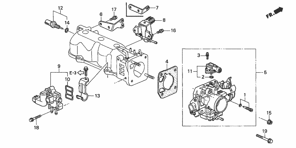

I think first we have to figure out what the "solenoid by the firewall" is.
How about #9 in the picture? That's the IAC valve for idle-control and cold-start. (Incidentally, #8 is the EVAP purge valve on the front side of the intake-manifold plenum)
Otherwise, go to your favorite on-line parts place.
(for example www(dot)hondaautomotiveparts(dot)com)
Click "parts"
Put in your car's information.
Select a category & browse the pictures until you find what that part is.

PS... I should have also suggested looking at the "engine mounts" category for the solenoid that controls the vacuum-operated rear engine mount.
If that system is leaking, I'm not sure whether that would contribute to a P1457.
