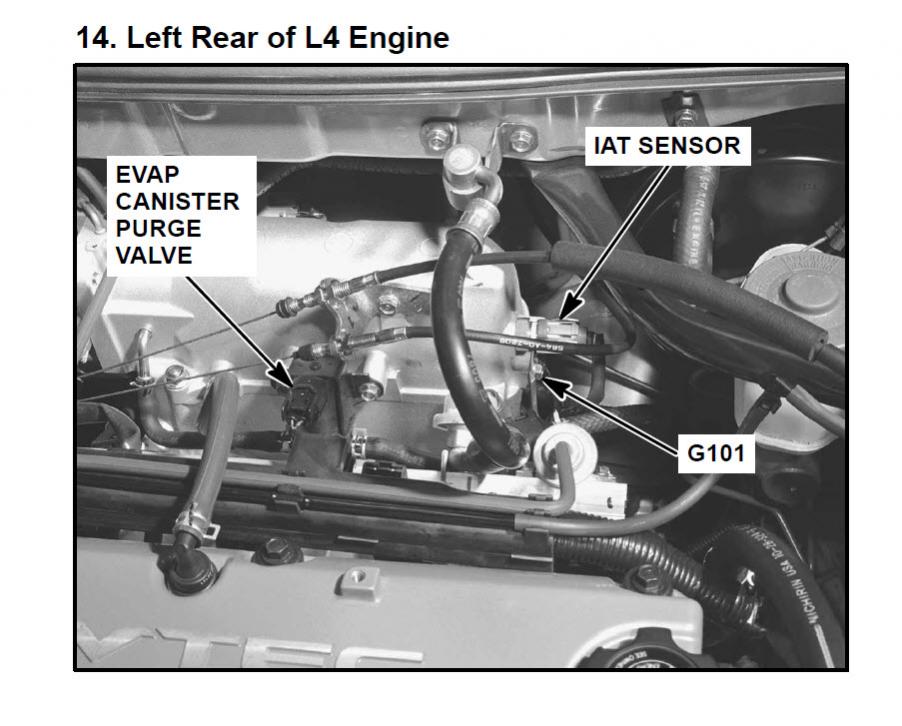

Old Jul 9, 2013 | 11:39 AM
Check that ground G101 located on the intake manifold is clean and secured.

Old Jul 22, 2013 | 07:00 PM
Recheck the main ground (G101) to be sure it is on and clean and tight.
EDIT: #16 in the pic
