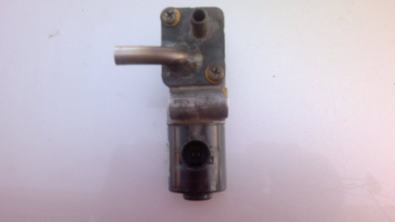

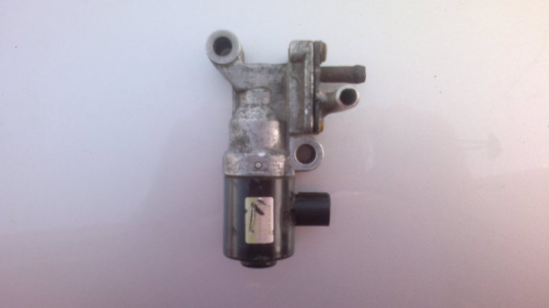

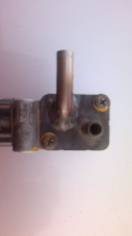

Ok so i listen to Roader i got the adapter plate its the only way to go! i guess if you do this you have to get your old IAC valve modified. in reference to the nipple that hits the tps sensor. no way around it so at work. had a 3/8 stainless steel tube bent and welded free of course; but it had to be pointing at 11 o'clock . This guy welded it at 9 it works but you will have the hose rubbing the fire wall

Beautiful welding! Beats the hell out of my brazed copper elbow.
Consider buying another IACV cheap at the junkard. Buy the guy at work a 12 pack, have him bend tubing into an "S" (two 90° curves), and weld that on. That way the coolant line will go over the TPS and point towards the right side of the car.
