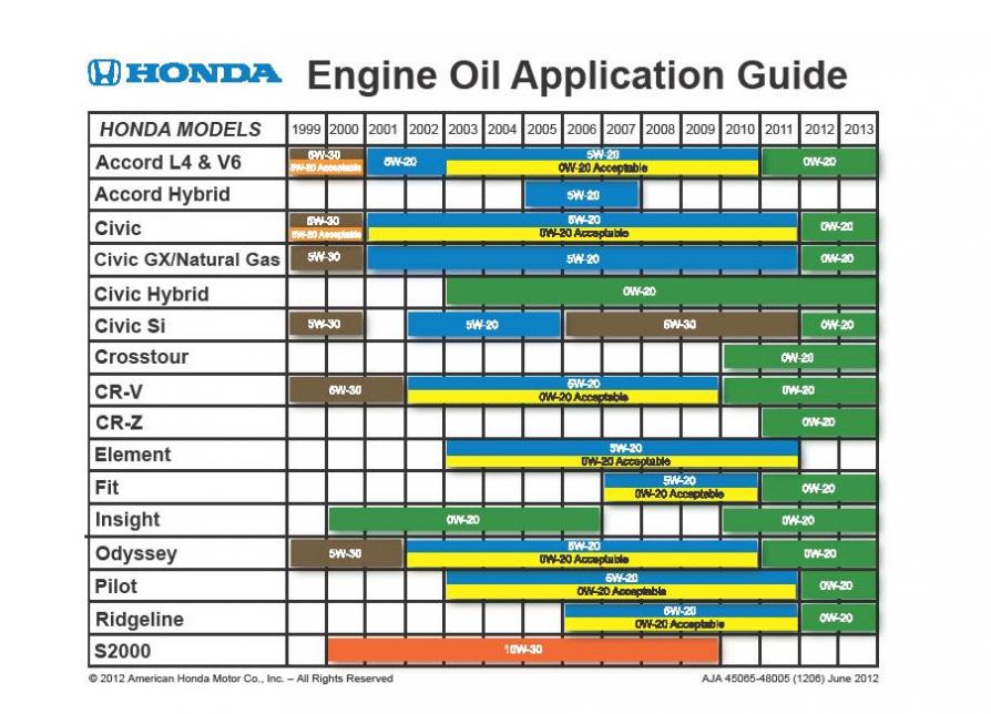

1. The last I heard, 0W-20 only comes in synthetic.
2. You can use 5W-20 conventional oil; but, I would follow the oil viscosity of 0W-20 recommended by Honda.
3. Honda does not recommend the factory fill oil to be changed until the maintenance minder is around 15%. There is molybdenum (that’s “moly” for short), a special lubricant applied by the factory to critical engine components during assembly, that will become mixed with the factory fill oil.
Just make sure it’s at the right fluid level and top off as necessary. To ensure proper engine break-in, the factory-fill engine oil should remain in the engine until the first scheduled maintenance time.
See copy of Honda Service News:
Honda Service News August 2006
Your car has a maintenance minder. Either follow that, or like a lot of people that use synthetics, change around every 5k - 7.5k. Some people go longer.
3k is too early for a synthetic.
If you want the Filtech oil filter; Honda part number 15400-PLM-A01 are made by Filtech.
15400-PLM-A02 are made by Fram/Honeywell.

Why would you ever even consider using a "lesser" oil than what is recommended by Honda? The fact is, 0W-20 oil is equal to or superior to 5W-20 oil in every metric used to evaluate oil. Geez, even for cars which come with a factory recommendation of 5W-20 I would never use that stuff, it's 0W-20 or nothing (which by definition isn't an option).
