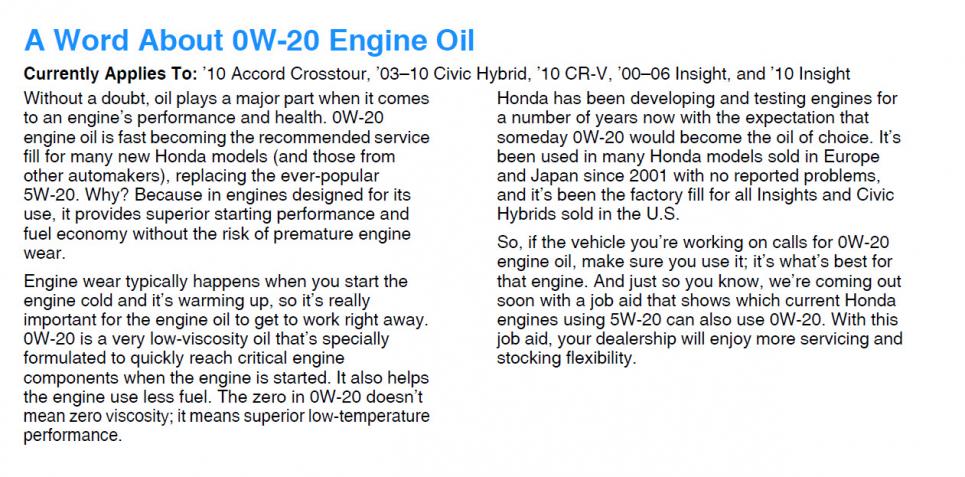

This is something from a Honda Service News a while back, see attached.
