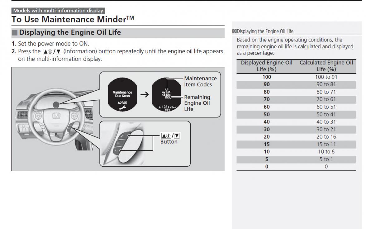

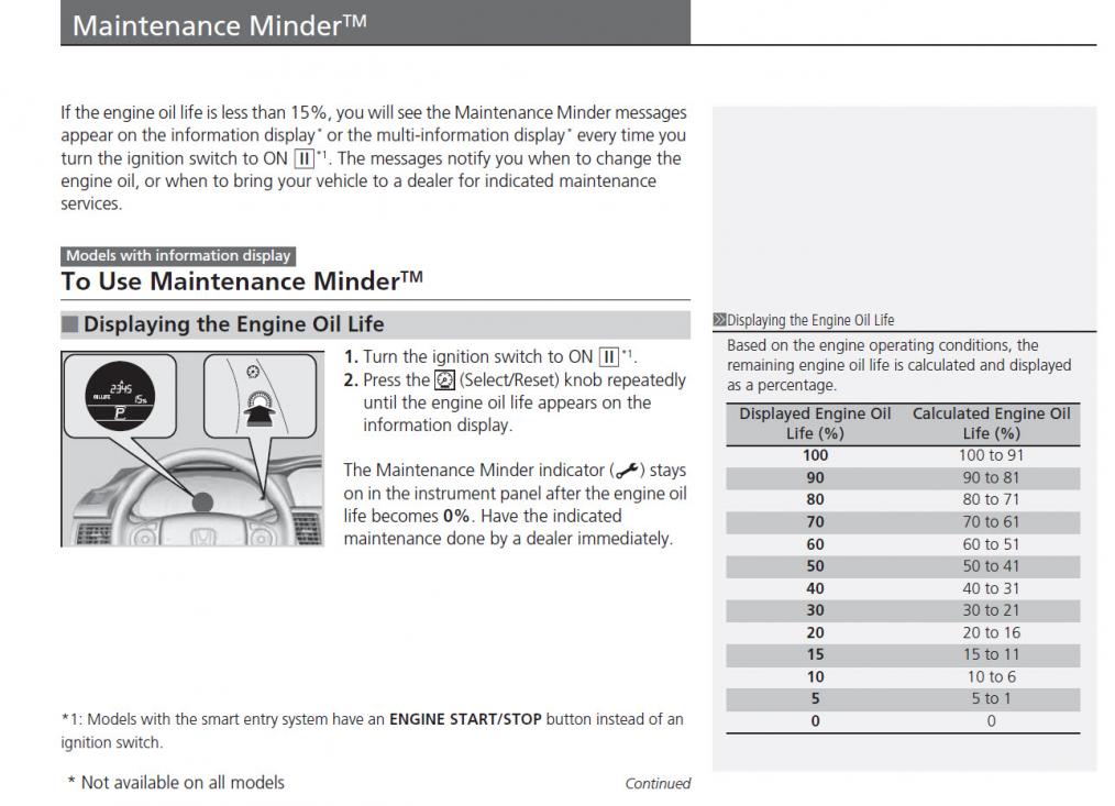

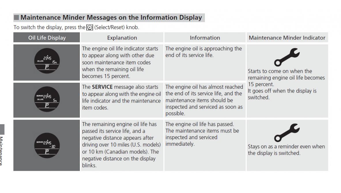

Hi all,
I'm a new driver and I got an 2013 LX last December. It runs about 1000 miles right now. I read from the manual that there is a maintenance minder to monitor the oil life but I couldn't figure out how to display the oil life on my own car. Does the LX model has certain system? If not, when do I need to change the oil?
Thanks a lot!
Sissi
Old Feb 26, 2013 | 08:03 PM
If your car has the regular information display, refer to the first 2 attached pics. from owner's manual.
If your car has the multi-information display, refer to the third pic. attached.
Attached Thumbnails 2013 LX first oil change-reg-info-display-maintenance-minder.jpg   2013 LX first oil change-reg-info.-display-maintenance-minder-contd.jpg   2013 LX first oil change-multi-information-display-maintenance-minder.jpg
