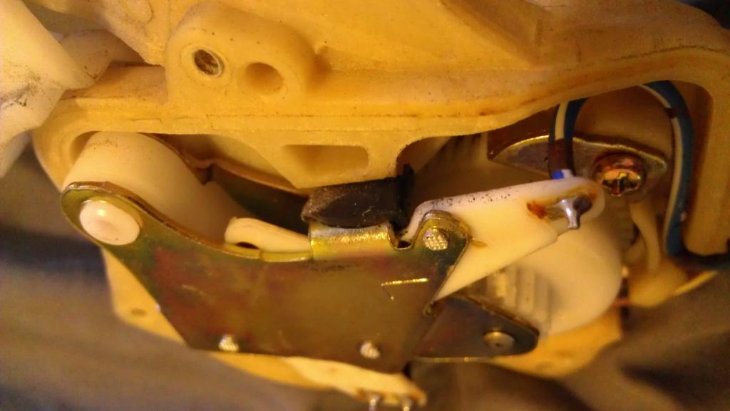

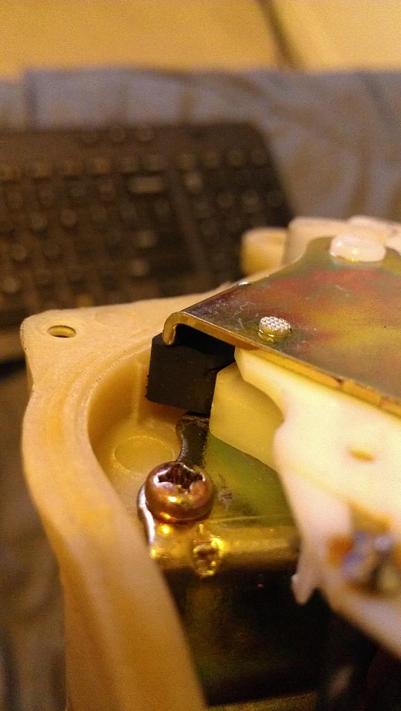

Old Feb 26, 2013 | 11:08 PM
sogone209's Avatar
Joined: Feb 2013
Posts: 6
Attached Thumbnails 97 driver door wont lock-imag0004.jpg   97 driver door wont lock-imag0002.jpg
Old Feb 26, 2013 | 11:09 PM
sogone209's Avatar
Joined: Feb 2013
Posts: 6
see my pics. the actuator looks fine to me as compared to another one. plz help.
Old Feb 27, 2013 | 12:06 AM
Posts: 7,101
There are two rubber stops inside the actuator, make sure both are okay. Your picture only shows one of the two inside each actuator.

redbull thanks for your reply.
the spring busted threw the plastic under the bottom gear. TIME FOR A NEW ACTUATOR )))
