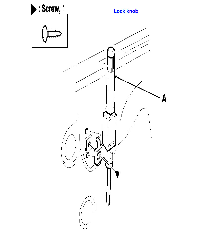

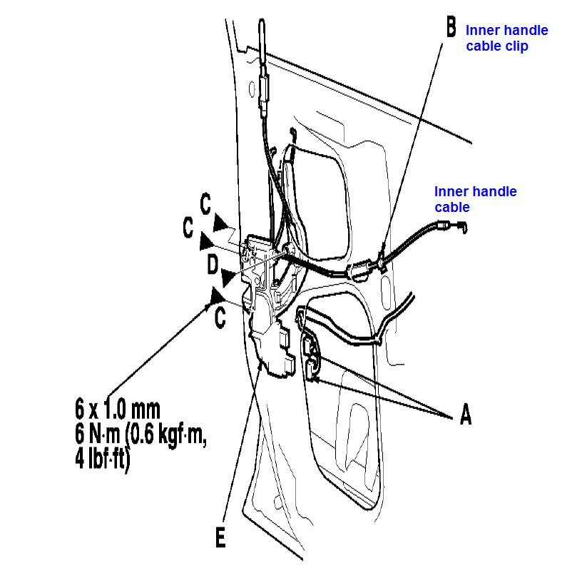

Old Jul 11, 2012 | 10:15 PM
Then recheck the installation, especially the inner cable, the inner cable clip, and the inner handle.
I've attached some pictures.
Attached Thumbnails Fixed my passenger side power lock BUT...-inner-handle.jpg   Fixed my passenger side power lock BUT...-actuator-latch.jpg   Fixed my passenger side power lock BUT...-outer-handle-rods.jpg   Fixed my passenger side power lock BUT...-lock-knob.jpg

Originally Posted by PAhonda
You will have to follow the metal rod (or maybe cable) from the inside handle to the lock mechanism. Maybe you forgot to attach it when reinstalling the lock mechanism.
Yeap..i ran the cable from the handle back down to the actuator. There is one screw holding the cable bracket to the actuator (also two clips on the side)...
When i pull the handle from the inside I see no movement from the cable...im going to mess with the cable attaching to the actuator tomorrow after work.....it has to be something with that...
