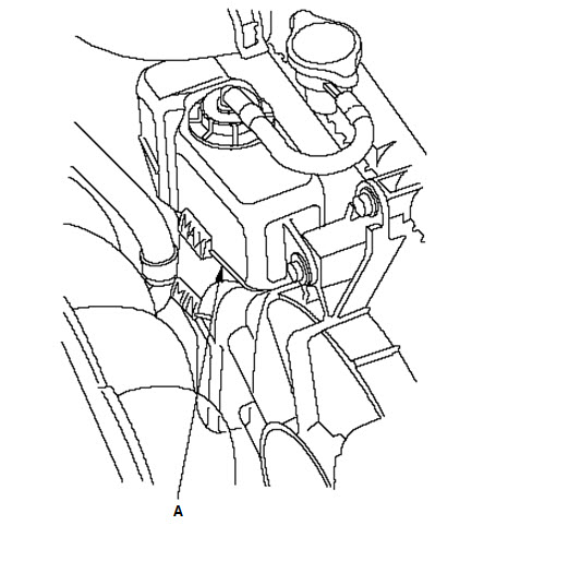

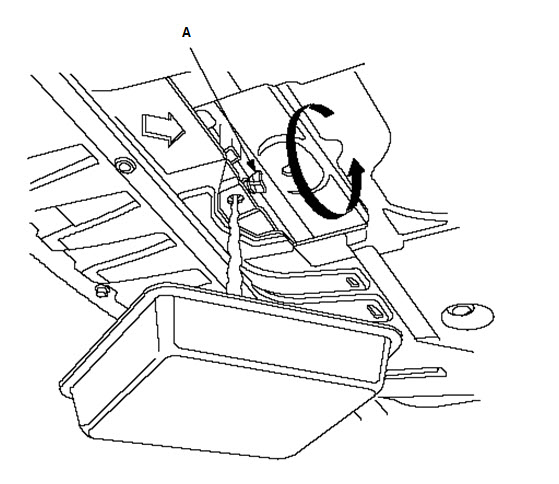

Here are the service instructions:
Coolant Replacement
  1. Start the engine. Set the heater temperature control dial to maximum heat, or climate control system to HI, then turn off the ignition switch. Make sure the engine and radiator are cool to the touch.
  2. Remove the radiator cap.
  3. Loosen the drain plug (A), and drain the coolant.
  4. After the coolant has drained, tighten the radiator drain plug.
  5. Remove, drain and reinstall the coolant reservoir.
  6. Fill the coolant reservoir to the MAX mark (A) with genuine Honda Long life Antifreeze/Coolant Type 2.
  7. Pour genuine Honda Long Life Antifreeze/Coolant Type 2 into the radiator up to the base of the filler neck.
  8. Loosely install the radiator cap.
  9. Start the engine, and let it run until it warms up (the radiator fan comes on at least twice).
  10. Turn off the engine. Check the level in the radiator and add coolant if needed.
  11. Put the radiator cap on tightly, then run the engine again and check for leaks.
Attached Thumbnails Fluid Changes-drain-petcock.jpg   Fluid Changes-coolant-reservoir.jpg
