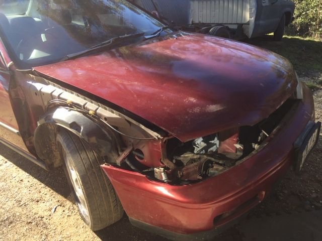

The pics: One shows the 'orrible thing with wing removed and broken headlight removed. Note that I've removed lots of bumper fasteners so I can drop it down on the RHS to gain access to the EVIL screw! (See other pic).
