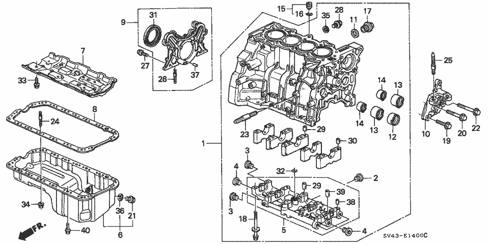

The rubber seal is shown in the picture here, #31. There's a larger plate to be removed as shown. Don't remove the crankshaft, but you have to remove the flywheel/flexplate.
For the PCV system, on a 4-cyl the motion of the pistons don't balance out perfectly. You think you feel air blowing out, but it's always sucking in & blowing out during each stroke. You only "feel" the blowing out, you don't feel the sucking in.
Sure, you can look at all the hoses for being cracked or rotted, and a new PCV valve only cost a few dollars. But I would pay more attention to whether the breather tube is blowing much oil into the rubber intake duct (upstream of the throttle body). That feeling of air puffing out of the oil cap can be pretty misleading.

Wow thank you so much Jim, this info and diagram is great. Perfect breakdown that I was hoping for and a relief that its not needing a crank removal. This weekend ill get a good chance for some time as to breather tube setup and and change the PVC valve, at $5 its a good start. I'll let you know what I find if there is even everything wrong. Like you said i'm concentrating more on the blowing out feel.
I truly appreciate everyones input.
