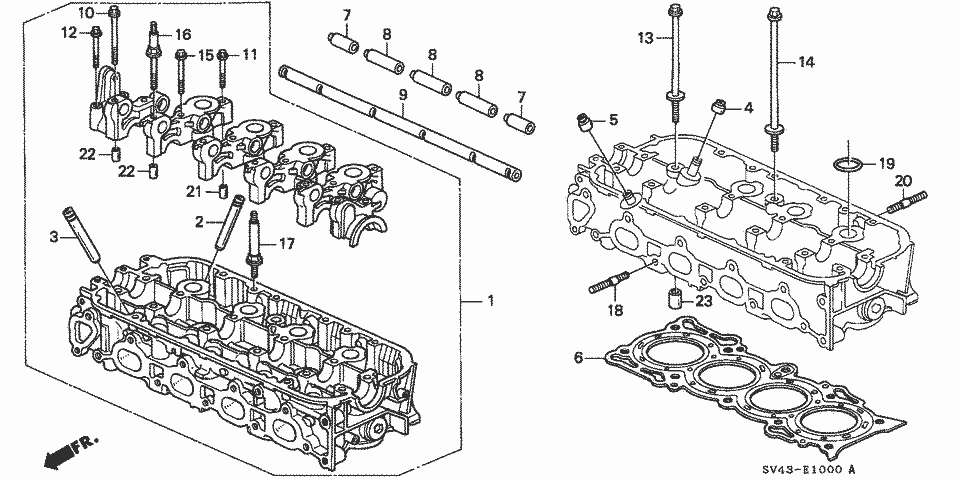

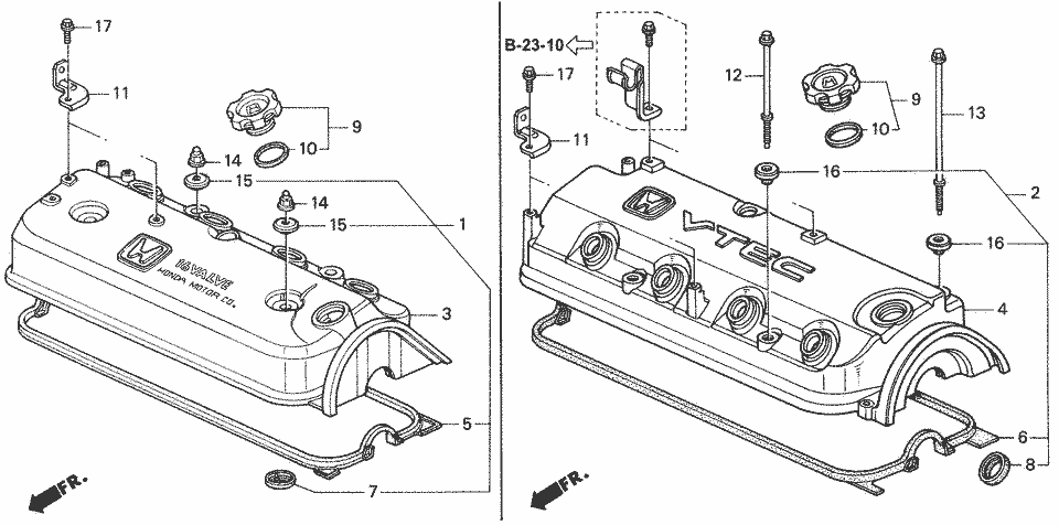

Here's 2 more pictures, for the question about oil in the sparkplug tubes.
For the LX (non-VTEC) they're not "tubes" pressed into the head. That's on the VTEC engine as far as I know.
The picture of the valve covers, your LX is on the left. The upper tube seals are #7, and there's one on each tube. They are generally considered to be part of the valvecover gasket and that's how easy they are to change.
The lower tube seals are actually O-rings (#19 in the other picture) fit between the head and the camshaft bearing caps. To replace them, you have to remove the rockers & bearing caps. Big job. I would try the upper seals first, before taking all the valve gear apart. If you have to go back & do the lower seals, then the upper seals are pretty new and still flexible when you R&R them again.
PS. Before doing the LOWER seals, make sure you have the tightening sequence & torque for the cam caps.
Attached Thumbnails General Help-1996-cylhead-cover.gif   General Help-1996-cyl-head.gif

Just saw the pic diagrams. Thanks so much JimB
This is really was I needed to see and explained, much appreciated buddie
