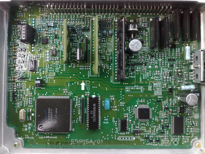

not goin too well.. with the swap we kept the original wiring harness, put in h22a dohc vtec motor, trans and ecu. i wired map and knock sensor, only error now is 7, tps, i tried a new one and still no response when rotating it or unplugging it.. and I wired it directly to ecu.
how does it run? idles ok but hardly accellerates and after ten min of driving, not at all. if i turn it off for a bit I can go another 10 min. error code = 7. does anyone know which ecu this is in the picture and if this could be the problem? it came with the new motor which was 92-96 prelude.

I can't tell from looking at the inside but does it have a white sticker on the side with a code? It should be a P13.
The problem you describe doesnt sound like it could come from a bad TPS. I have driven with a wrongly set TPS and no TPS at all and it didnt run anywhere near that bad.

Aren't these the ones where the map and tps can get swapped by mistake?
