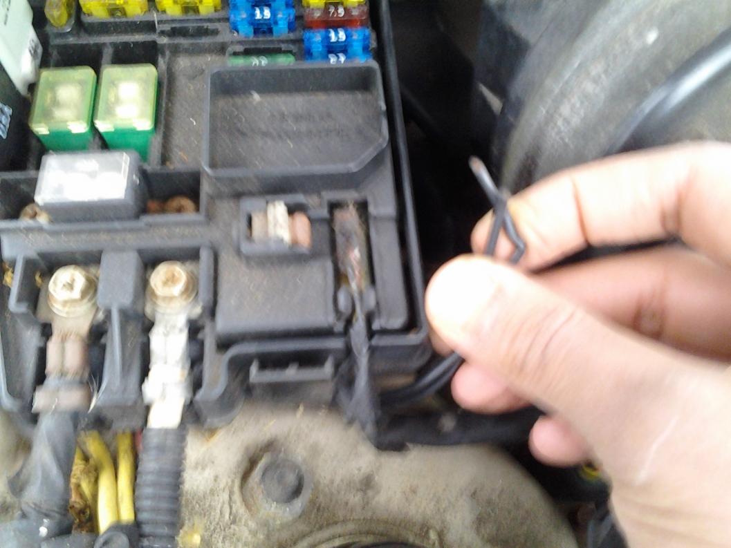

img1 - Here im showing the two black wires next to the underhood fusebox(my guess they beling somewhere near that connector w fuzzy wires)

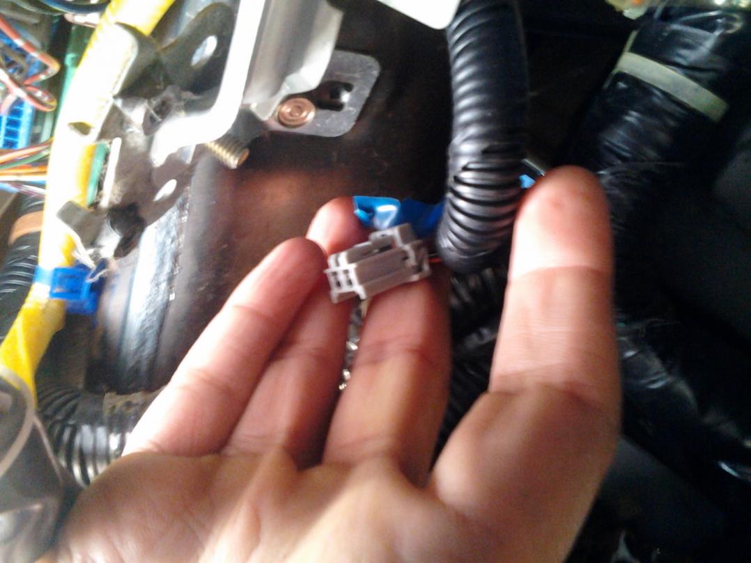

img2 - these are teh 2 black wires that were cut and dangling under the dash

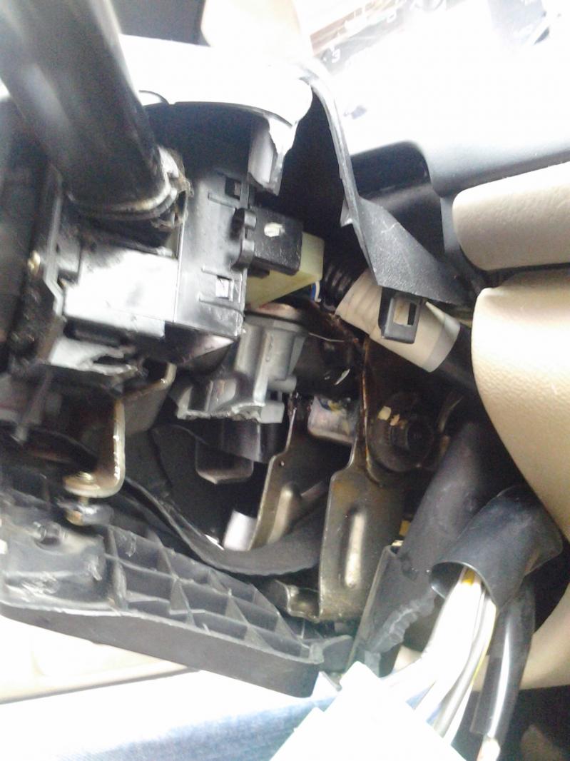

img3 - this is the connector under the dash, there is nothing plugged into it and guessin the black wires were part of the plug that went into it

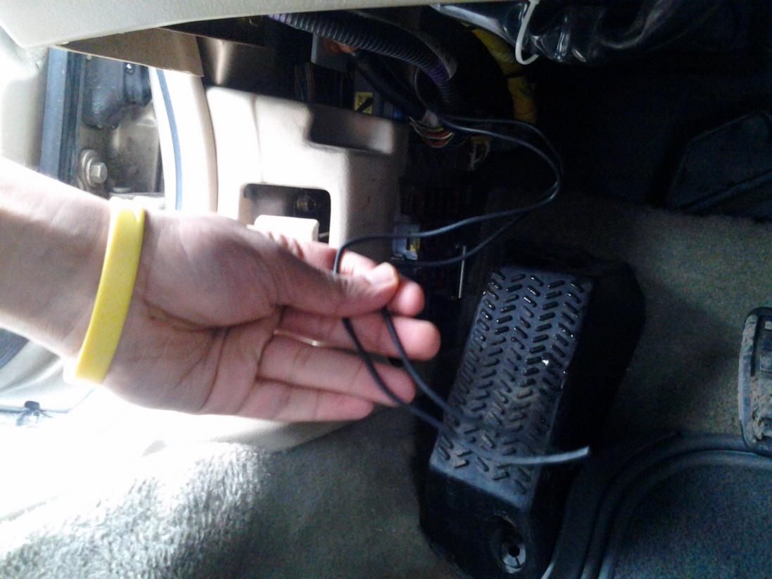

img4 - right side of column with igniton assembly broken off

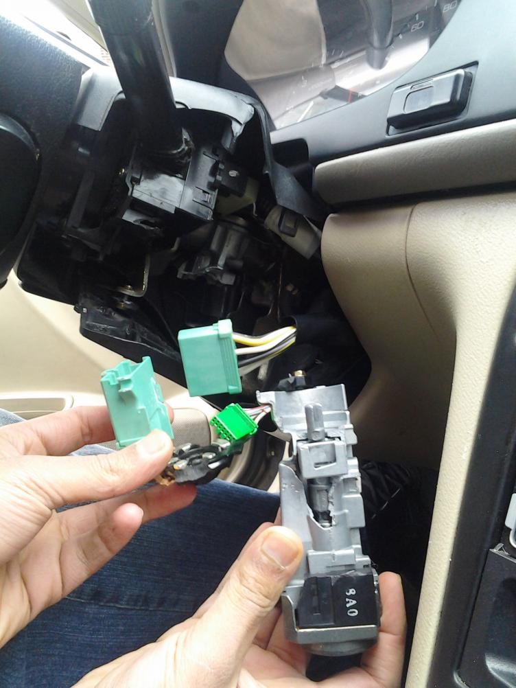

img5 - contd from img4, the upper half of the ignitoin assembly is still attached to the braket, so prob have to drill the screws to put new one
Basically, im guessing i def need new igniton assembly, but cant figure out the 2 black wires but think they were starter related and need to know the plug they fit into. They run from underhood fusebox, through the firewall, to underdash just to be clear.

I would start with the simpler stuff first.
1. You will need to replace the electrical portion of the ignition switch. You can also replace the wire harness from the ignition switch to the under dash fuse box.
It looks like the mechanical side of the ignition switch is broken from the pics (I can't tell for sure). That part is really expensive, so you may want to pick up a used one at a junkyard. A locksmith should be able to put the proper tumblers in, so your original key will work.
2. Where is that electrical connector under your dash? What components are near that connector, because it looks like it was just unplugged. Also, what are the wire colors going to that connector?
Another question, how long was your car missing? Do those two black wires look like they are part of the car's original wiring harness, or do they look like they were added on? Does your car have some sort of security system installed on it?

That connector in the third pic is near the steering column and the wires in that connector are red and black. The car was missing for about 3 weeks, but i think police just took some time recovering it. The two wires im guessing were there only because they are routed threw the firewall and im guessin were part of a plug that went into that connector. No security system. As for the igniton assembly, i was thinking about getting the whole assembly with the switch and key part from ebay and plug into original harness.
Also, that connector in the third pic with the red and black wires comes off a bigger harness and just the red and black wires come off that harness which go into that mysterious connector.

You can install a used ignition switch into your car. Just remember that you will have to use a different key to start the car, compared to the one you will use to unlock your car. A locksmith should be able to transfer the tumblers from the original switch to the replacement switch.

Trust me, I already tried to find that two pin BLK/RED connector......haven't found it yet (on line or in the book). Is there another color on the red wire,,,, It maybe a small stripe or a "dash" of sorts.....Honda usually uses more than one color on the "red"" side.....I got a 7 and an 8 pin but no two pin.
From there, the wires in the first two pics do not look like factory wires....can I assume they are the same from under dast to under hood?

hey, i took off the dash piece and remembered there was a temporary horn installed so that takes care of the two black wires, which were visible behind the button.
-As for the connector, the red wire is all red but the black one has a stripe of white on it. I will be posting some pics of the connector. One more thing is that the connector comes of a harness that goes into the ecu (silver box near fusebox) and the other end goes to other connectors that go into the ignition. Once again ill try to post some pics because i cant tell if this connector was like this or not. In the meantime im gonna order the ignition assembly and just deal w seperate keys.

I'm begining to think that is the "key light"...more reading. If nothing else I might pull the covers on the 95 and see if I can find it....I've looked at the ing/wipers/washers and still can't seem to find this two pin RED and BLK/WHT wire.
