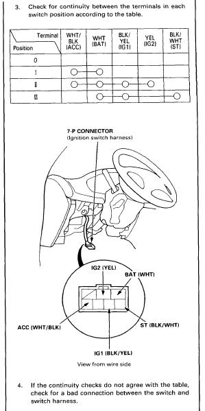

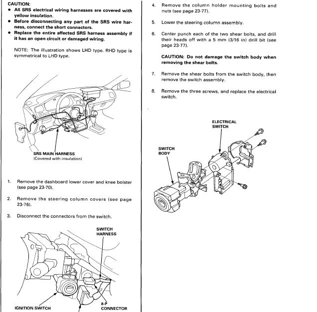

Old Jan 23, 2012 | 08:30 PM
The main switch should be like a 7 pin connector.....
Attached Thumbnails HELP! found my lost hotwired accord-5th-gen-ign-switch.jpg   HELP! found my lost hotwired accord-5th-gen-ign-switch-pins.jpg

the thing is that the old ignition assembly is broken in half are you saying to use my ign switch in the new used assembly? Also, i tested the used one by connecting the connector and harness in pic 1 but did not actually mount it with bracket could that be an issue and if not should i start to check the main switch for continuity?

Get a volt meter and do some electrical testing.
If you go to the common diy thread on top of the gen tech help forum, there is a link to online shop manuals where you can get a 94 shop manual.
Do the electrical tests for the 7-pin connector. The white wire going to that connector should have 12V.
Having that switch hanging will not stop it from working.
What is happening when you turn the key? Absolutely nothing?

For both of you, you may want to use a volt meter to see if the ignition switch is making the proper contacts when you turn the key to the II position. Get the shop manual that I mentioned in my earlier post.
You both need to figure out why you are not getting power to the proper places.
