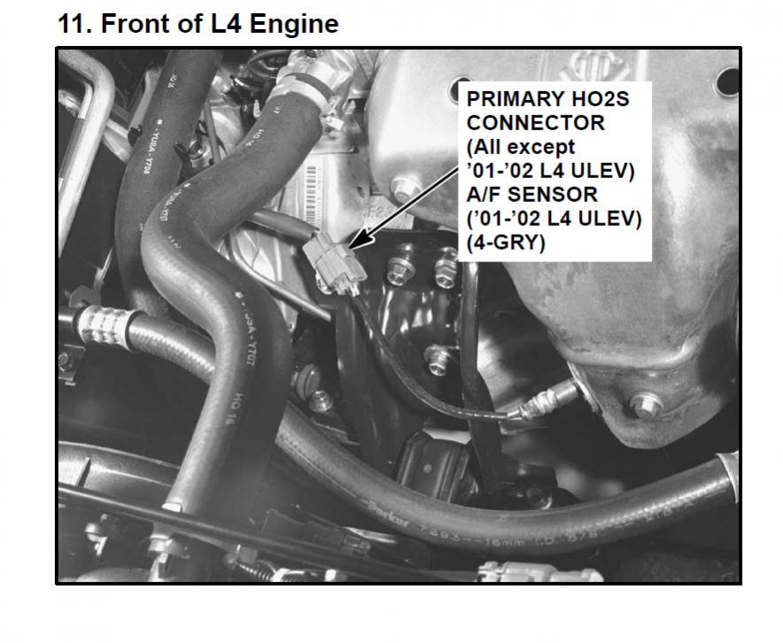

P1166 is Air/Fuel (Sensor 1) heater circuit malfunction.
P1167 is Air/Fuel (Sensor 1) heater system malfunction.
1. Both codes are related to the same primary sensor, located in the front of the engine. See attached picture. Your car is most likely a ULEV (Ultra Low Emission Vehicle) due to those codes. A/F sensors are a wide band type of oxygen sensor and generally a little bit more expensive than the regular narrow band sensor.
2. Generally, the A/F sensor will not cause your car to stall. The A/F sensor may cause some other issues though.

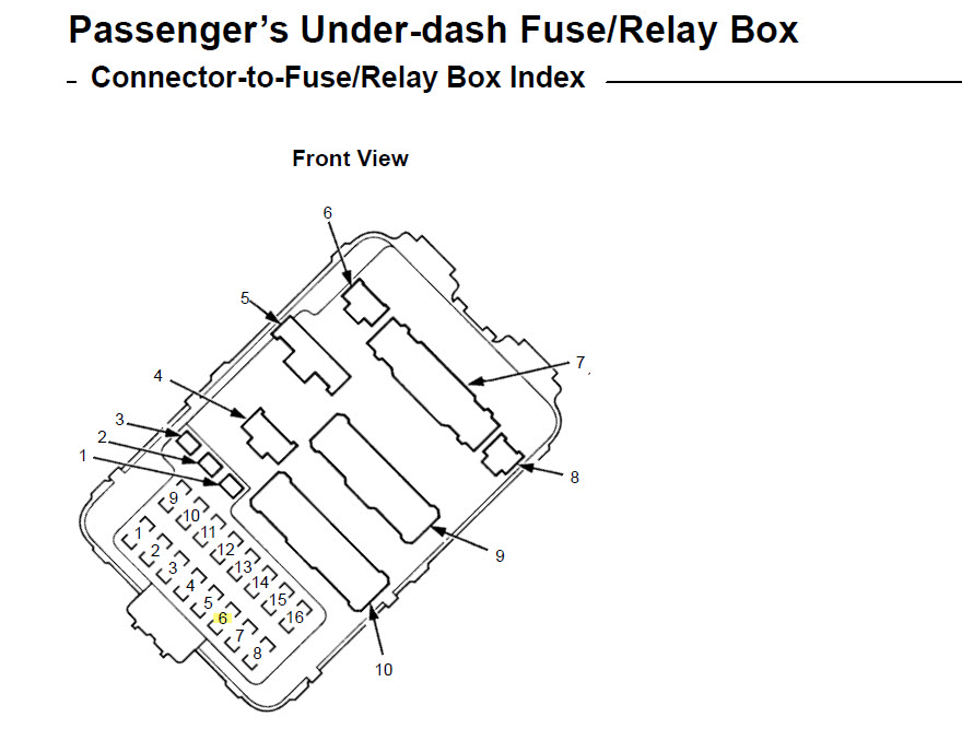

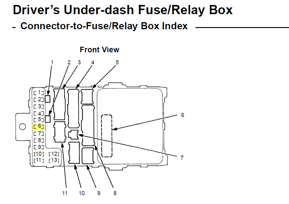

3. Check the following fuses:
  • Driver's side under-dash fuse no. 6 (15A).
  • Passenger's side under-dash fuse no. 5 (20A).
  • There may be another fuse, I will let you know if I can verify aa third fuse.

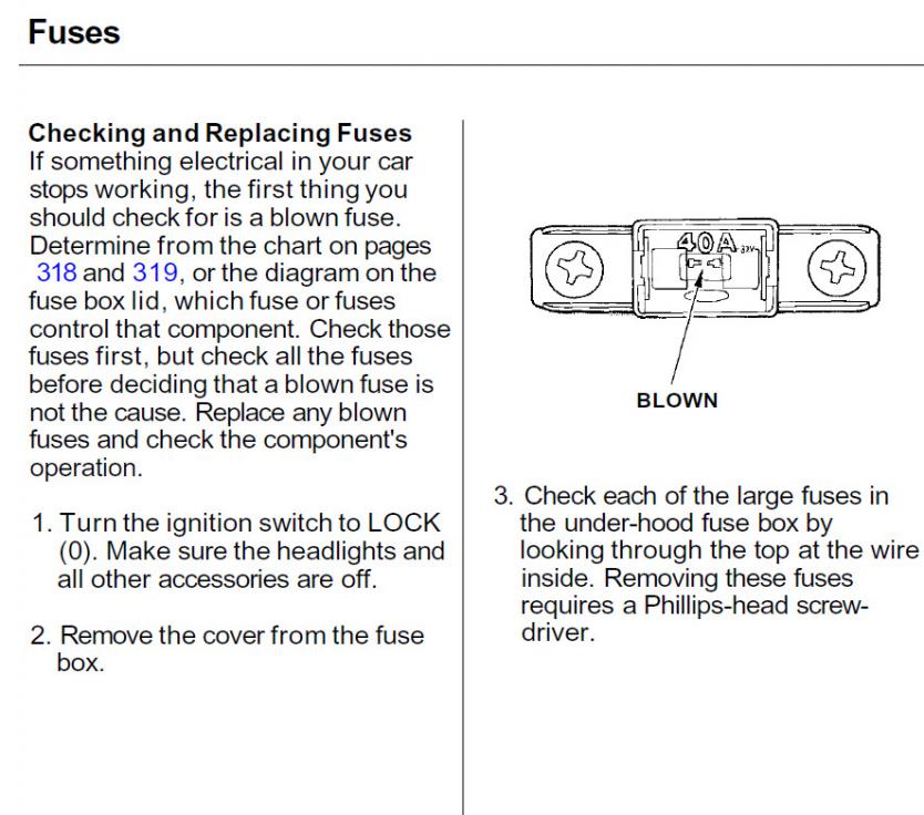

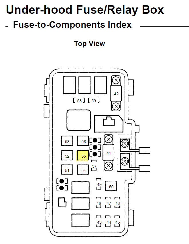

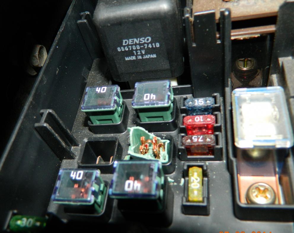

The large fuses in the under-hood fuse box doesn't require pulling to check. Those need to be removed with a philips screw driver. (See attached images) You should disconnect the negative battery cable first before you try to replace the large fuse. Under-hood Fuse No. 55 (40A) protects the passenger side Fuse No. 6 (20A) for the A/F sensor.
If the speedometer is not working, check the driver's side under-dash (inside the car) Fuse No. 6 (15A).

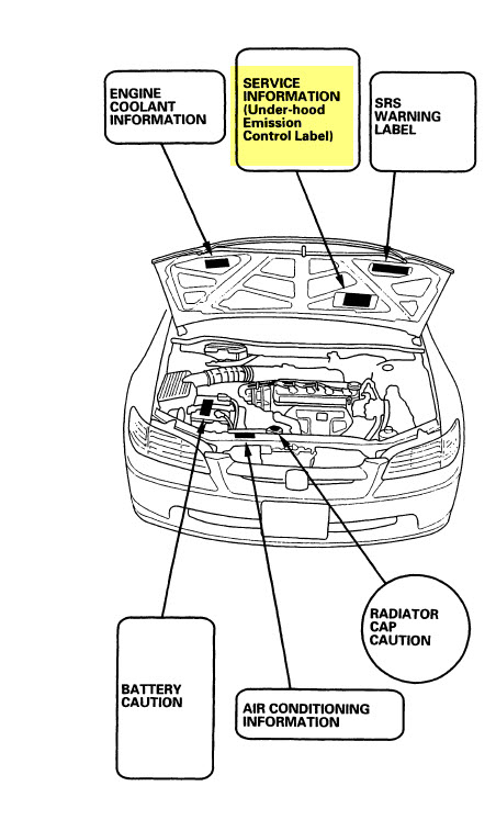

Like the picture above, does your engine says ULEV (green area)?
You can also look for the emission sticker under the hood area to see if it says ULEV. See attached image.
Or you can give me the VIN (pm if you like).

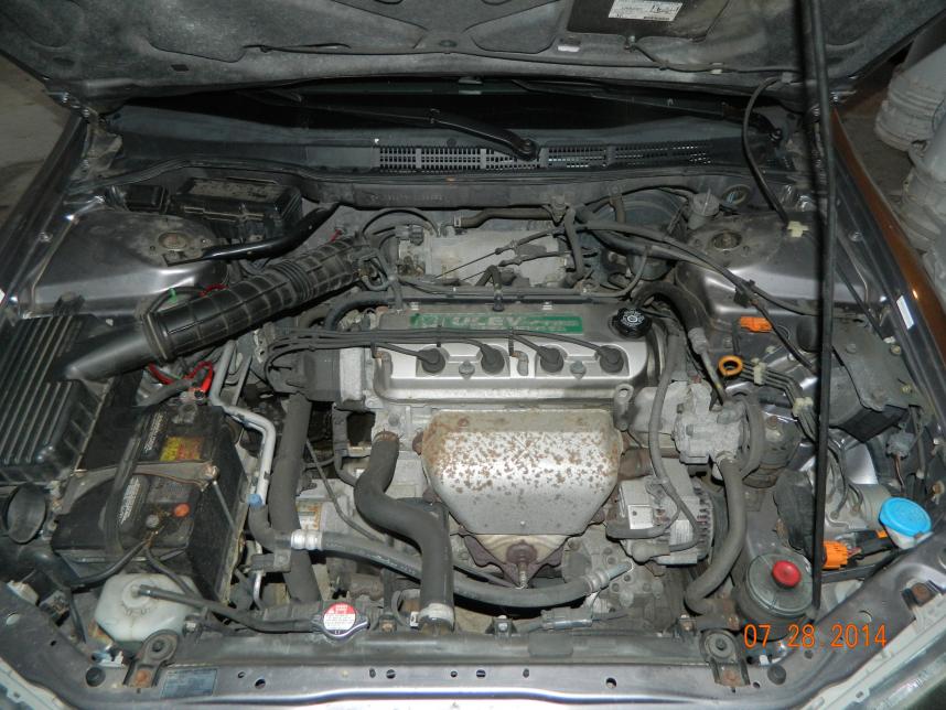

Default Pic of my engine and the fuse I broke
Attached Thumbnails Help with my 2000 Honda Accord please!-engine-honda.jpg   Help with my 2000 Honda Accord please!-fuse.jpg
