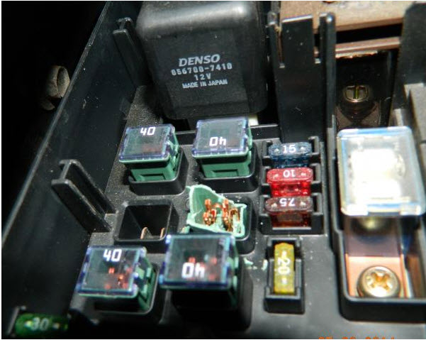

I just saw one of your album pictures of the broken fuse. That is a different type of fuse than the type held on with philips screws like I thought.
I would still disconnect the negative battery cable first for safety reasons since the terminals are exposed. You can still try pulling it with a pair of pliers to remove the remnants.

Did you see the pic of the fuse I broke? I dont see any screws to take that fuse out. Should I just pill it out with pliers on the metal part and put new one in? It wont electrocute me?

We posted at the same time; lol. See my reply above yours.
Edit: Try pulling on the plastic area first.

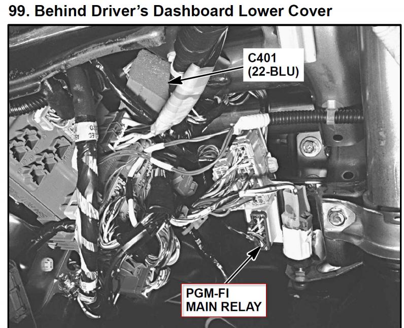

The stalling can be caused by different things; so, it can be a guess at this point. But, one possibly cause for the stalling may be a faulty main relay; which usually is due to cracked solder joints. The main relay solder joints can be touched up with a soldering iron or a replacement main relay can be used. The main relay can affect the operation of the fuel injector and fuel pump; as there are actually two relays inside the main relay module. However, keep in mind, the stalling can be due to other causes. You don't really want to just throw a part at it, if you can help it.
This link has some information on the main relay. In addition, I've attached a picture of the location of the main relay for your car.
Main Relay Fix, Troubleshooting (Honda, Acura) and how to solder
