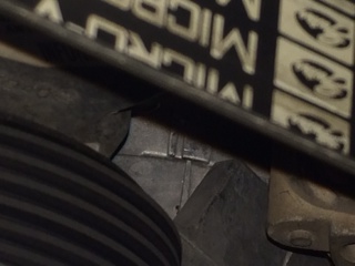

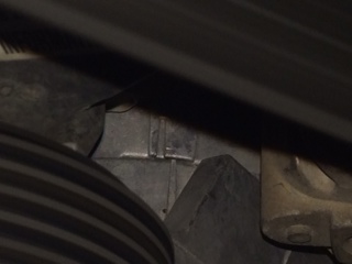

Thanks for the replay, here are a couple pictures that show the belt tension according to the marks on the tensioner. Not sure if that is fine. The still picture shows that I installed the Gates one.

Old Jun 24, 2014 | 08:40 PM
Looks like belt tension is in acceptable range and doesn't change. Not your problem.
