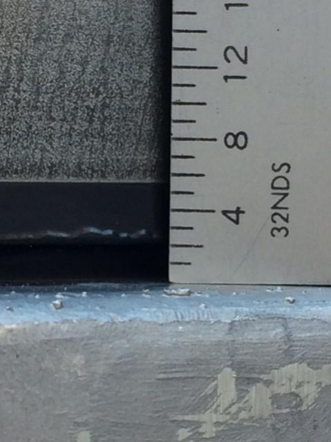

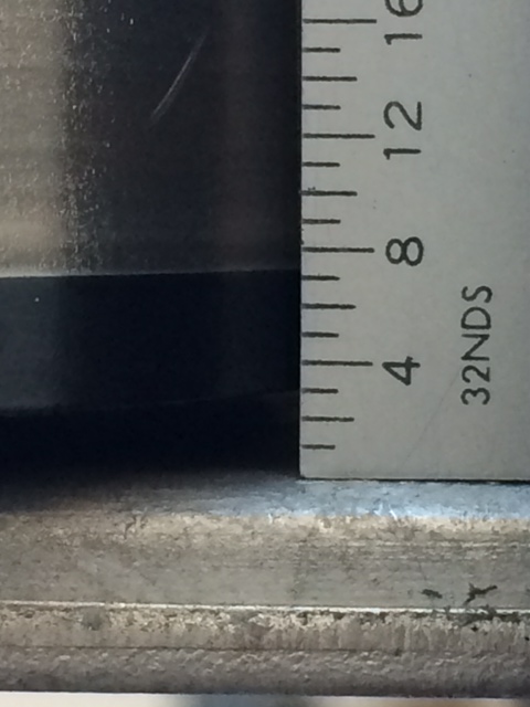

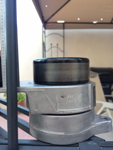

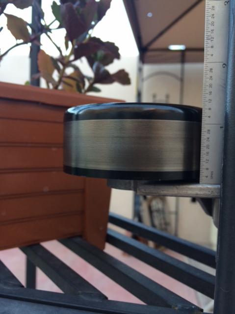

Old Jun 28, 2014 | 10:47 PM
  #18
jose1036's Avatar
Joined: Jun 2013
Posts: 10
Hi Texas H, ok, here is what I found: There is some misalignment between the pulleys. Please note the belt path on the two pulleys. There is also some weird pattern on the surface of the lower pulley that may be cause by the forced belt, and causing the whining noise.
Now the task is to find what is crocked. I guess is the A/C compressor-Alternator assembly. They seem to be attached to a fixture/body, which is also attached to the engine block.
You were right, thanks. Hope we are in the right way. Will continue tomorrow.

Old Jun 29, 2014 | 10:34 AM
  #19
Posts: 16,334
Try using a straight edge on the face of on of the pulleys, then see if the straight edge aligns with another pulley.
