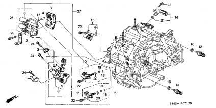

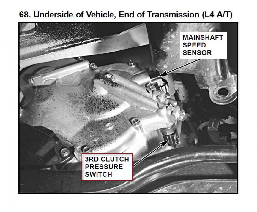

3rd clutch pressure switch should be Honda part number 28600-P7Z-003. Number 13 in this parts diagram.
I've also attached a photo of the location. You may want to check the wiring and connection first.
When was the last time the transmission fluid was changed? For maintenance, you may also want to change that if it hasn't been changed in over 30,000 miles.
